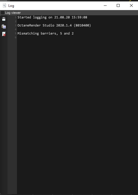

But sometimes, without ORBx in a main scene - IPR closed and I saw this:
Last edited by andrey.krivulya on Fri Aug 21, 2020 4:32 pm, edited 1 time in total.
Windows 11 Pro / Intel Core Ultra 9 285HX / 96GB DDR5 / RTX 5090 Laptop 24GB / 4TB SSD / MSI Titan 18 HX AI
My youtube channel with 3d tutorials ----- >>>> https://www.youtube.com/c/AndrewKrivulya
andrey.krivulya
Posts: 130
Joined: Wed Apr 06, 2016 6:15 pm
Hi, dear OTOY developers
So, I tried to catch this issue and recorded a video. In the end, you will see it... Sometimes it happens when I change the resolution and sometimes - when I just rotate camera =) Sometimes when just start an IPR =)
Video with the issue -> https://www.youtube.com/watch?v=z7_X_kTdLcM
The scene for investigation -> https://bit.ly/31hDt8T
Thank you and have a great day
