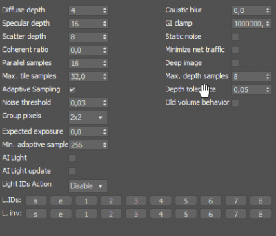

Hi samsue,
uncheck "minimize net traffic" in Kernel panel.

Hi Paride
It's already unmarked
