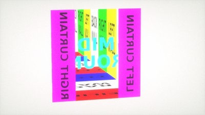

Does anyone have any knowledge of OSL Shader coding?
I've found a free script to add Interiors to windows which looks really good (replicates the effects from the old vRoom plugin).
Problem is the guy didn't have access to LW when he wrote it and kinda guessed about the mapping (Was written back in 2017).
I've tried poking around the code, but have no idea how LW deals with it's mapping in terms of OSL.
Would be extremely grateful if anyone would be able to take a look at it and maybe fix it? (I think other people may be quite grateful too)
I've included the shader script and 'template' image along with an IPR render of how it's currently (not) working.
(would also be very handy to change the 'string' input to a texture image :) if that's possible)

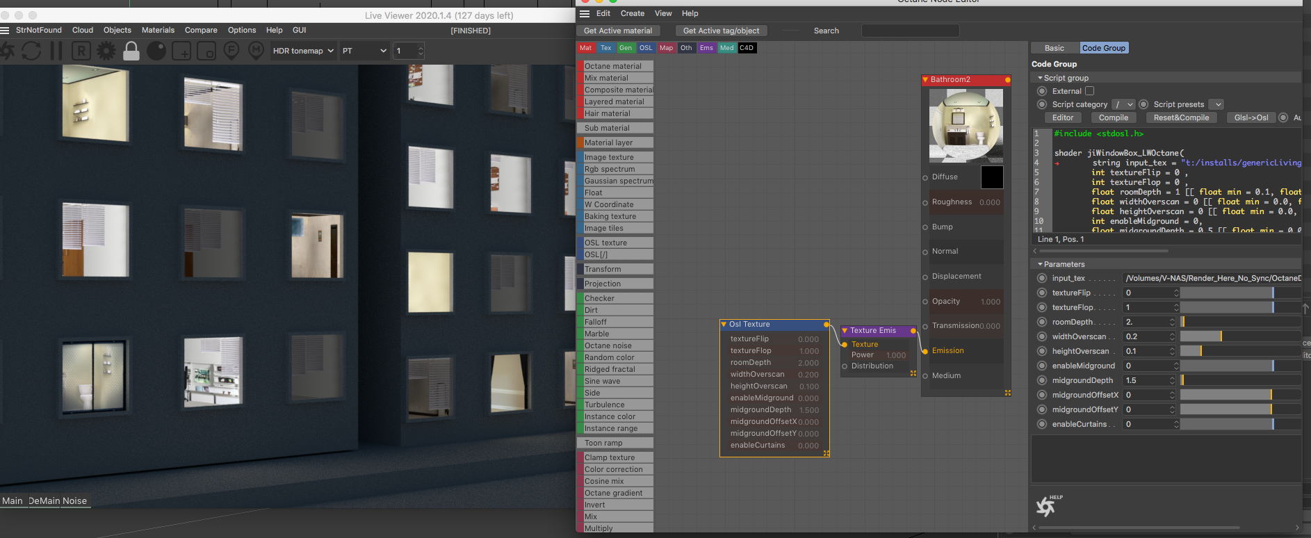

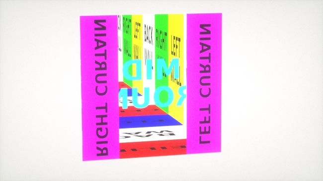

Okay, so this is really weird.....
I found this tutorial digging around the older posts about OSL.
https://vimeo.com/303298454
Weird thing is, it uses the exact script that I posted and it works fine, so I am very very confused.
Has something changed in the way the OSL node reads/parses things?
TheMightySpud
TheMightySpud
Posts: 71
Joined: Thu Jun 06, 2013 11:19 am
Even more bizarre-ness going on with OSL.
The room shader now works. Was curious if the rotation of the plane had any bearing on the results. So so in modeller, I rotated it 180 degrees, all went even more screwy.....rotated it another 180 degrees and it now it works fine. wtf? lol.
Now trying to get the tiled image shader to work.....currently not doing a danged thing. lol.

TheMightySpud wrote:Even more bizarre-ness going on with OSL.
Oh, right, I forgot about that weirdness. Yes, the orientation of the geometry matters in a strange way, based on global coordinates. I could rotate an object and have the material stick properly, but the initial texture projection coordinates of the desired face needed to be on the Neg Z. I'm afraid I never dug into it enough to figure it out, since I found a work-around (create all windows facing -Z, then rotate into proper position) and had a deadline to meet.
Try applying it to a simple cube to see some real wackiness. If it's like in C4D, it will be clear that it only works properly on the -Z face. I'm guessing that to work properly, this script needs a seperate Image Texture node input, and then that node needs a Projection node with, "OSL Projection," or "OSL Delayed."
TheMightySpud
Posts: 71
Very baffled about the projection direction tbh, as it's the same as it originally was, just with a 360 rotation. So very very stupid. lol.
