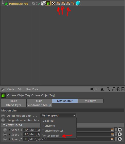

I'm using RF Connect to import BIN mesh object sequence (in both Max and Cinema is the same, we load BIN objects);
Now, in Cinema we have a Vertex speed motion blur type which uses velocity channel from RF to blur the liquids
Similar to here, just with using imported geometry, not RF plugin inside cinema:
http://www.aoktar.com/octane/OCTANE%20H ... nBlur.html
But in Max I can't find the same settings so I'm wondering if it is a different workflow or we can't use velocity channel for the blur in 3dsmax?

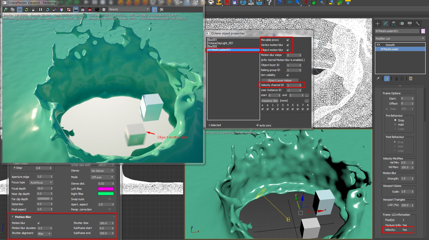

Check here, I think everything is set as it should be but fluid isn't getting any motion blur.

maneality wrote:Check here, I think everything is set as it should be but fluid isn't getting any motion blur.
Hi maneality,
could you share your .max scene in order to figure out (in pm if you want).
Regards
Paride

Hi maneality,
it seems no velocity channel available from the object's mesh, could you confirm you added it or could you try to add it?
Regards
