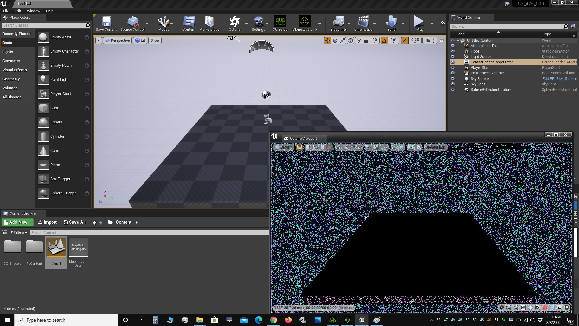

Notiusweb
Posts: 1285
Oh boy....what'd I do now.....
At default 0.39 on UE 4.25.2

How did that black spot at the top appear? Did you reinstall the plugin and did it fix it
ChrisHekman
Posts: 1160
Joined: Wed Jan 18, 2017 3:09 pm
Notiusweb wrote:Oh boy....what'd I do now.....
Do you have the same issue with 2020.1.4 standalone?
And could you try to re-install the plugin. (Note that you have to turn unreal off before reinstalling).
Hello, I did reinstall and that fixed it. Maybe it was because I installed it while it was running, I don't remember. :oops:
But after the reinstall it is working, THX!
