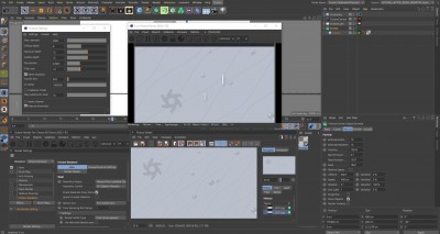

I checked some settings and now only some spheres (created by the Emitter) are affected by the motion blur.
But there is one more thing. That MB is only shown in the Live Viewer but not in the final render(as the picture that I'm attaching is showing).

And here is the file and the pic that I mentioned before : )
Raindrops without MB.rar
(47.65 KiB) Downloaded 307 times
Posts: 10651
Confirmed, there is an issue with motion blur and sandard emitter in Picture Viewer, I’m going to report this to the devs.

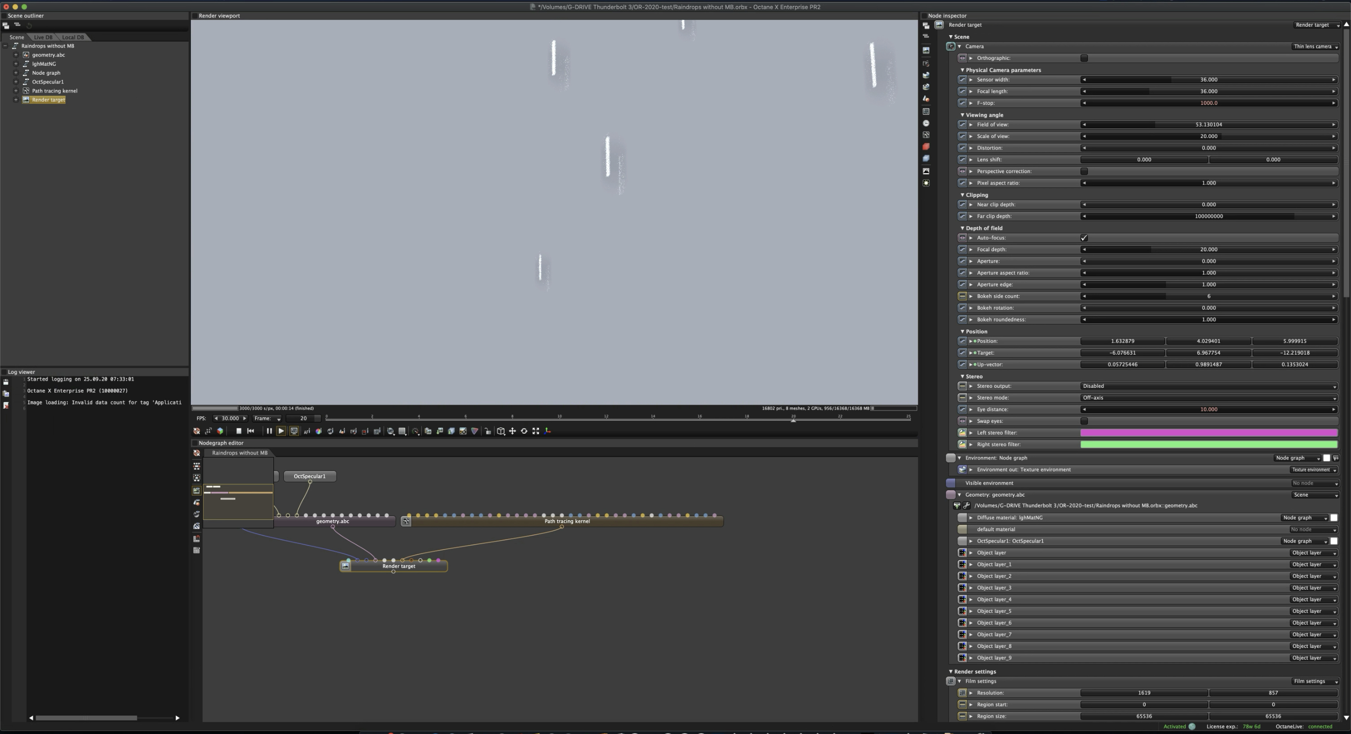

But, if you export the scene to Standalone, it works correctly, and you can render from there:
