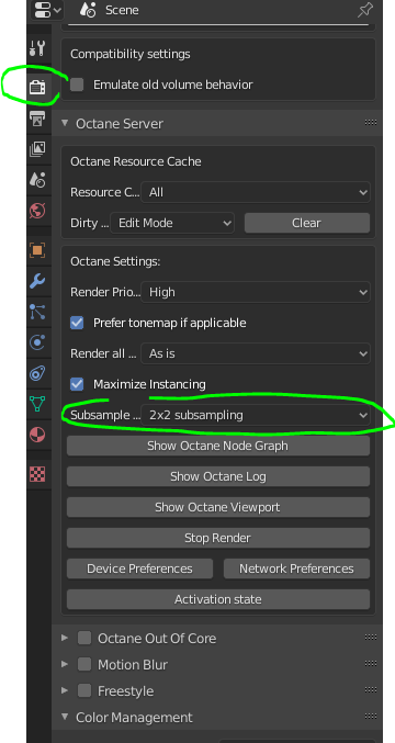

linograndiotoy
Posts: 1403
That's a perfectly normal behaviour. You can use the Subsampling option to solve it.
