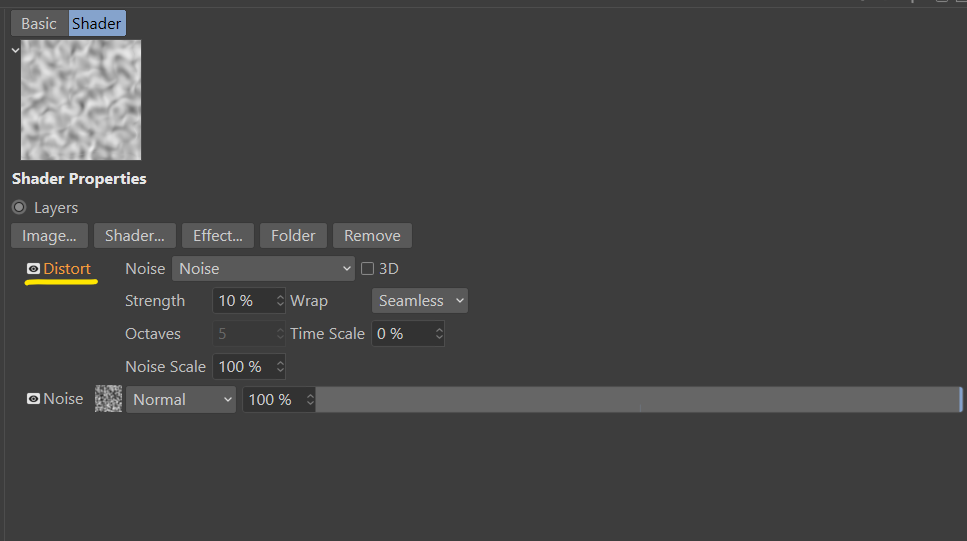

Is anyone aware of an OSL texture in Octane that will distort its input image with noise? I'm looking for something similar to C4D's native Distort Effect.

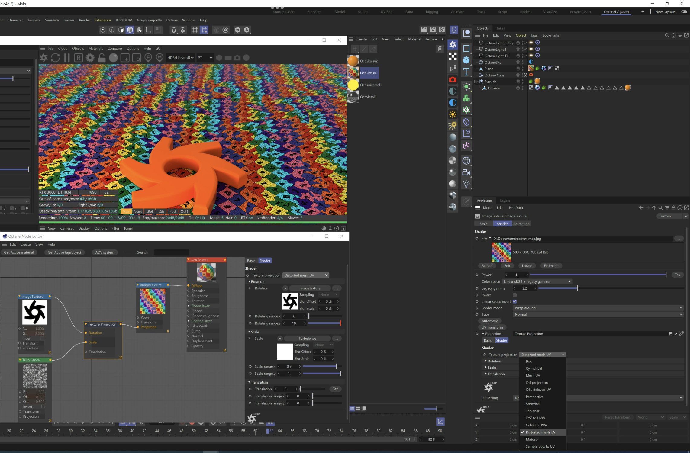

Posts: 10611
from 2021.1 there is a new Distorted Mesh UV projection mode, no need to use OSL:
