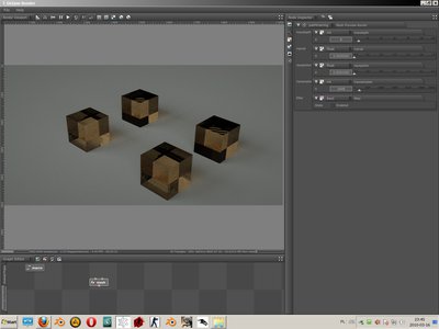

I can't do galss material in octane (working in blender 2.49b) becouse there are errors and it doesn't looks good (octane wersion 0.81a) and i don't know how to change transparency of the material. If you can you can make short tutorial how to made a realistic glass.

Hi there,
You change the transparency by adjusting the Kd value, which by default is a color. Set this to pure white will create a 100% transparent specular material.
Colors will result in a tint of the material and black will absorb all lightrays.
What specific errors do you speak of ?

MDkai wrote:You change the transparency by adjusting the Kd value, which by default is a color. Set this to pure white will create a 100% transparent specular material.
Actually this is one place where the current manual differs from the beta. The beta calls the first two specular parameters 'Ks' and 'Kd', whereas the manual calls them 'specularity' and 'transmission'. I assume this small error has already been caught?
If you change the material from a glossy to a specular, it will retain the ks and kd descriptions. If you change from diffuse straight to specular, you will see the specularity and transmission descriptions as it should be. This appears to be a bug. I'll report it to Radiance.

Thanks MDkai.
i think that the errors are couse by normals.
