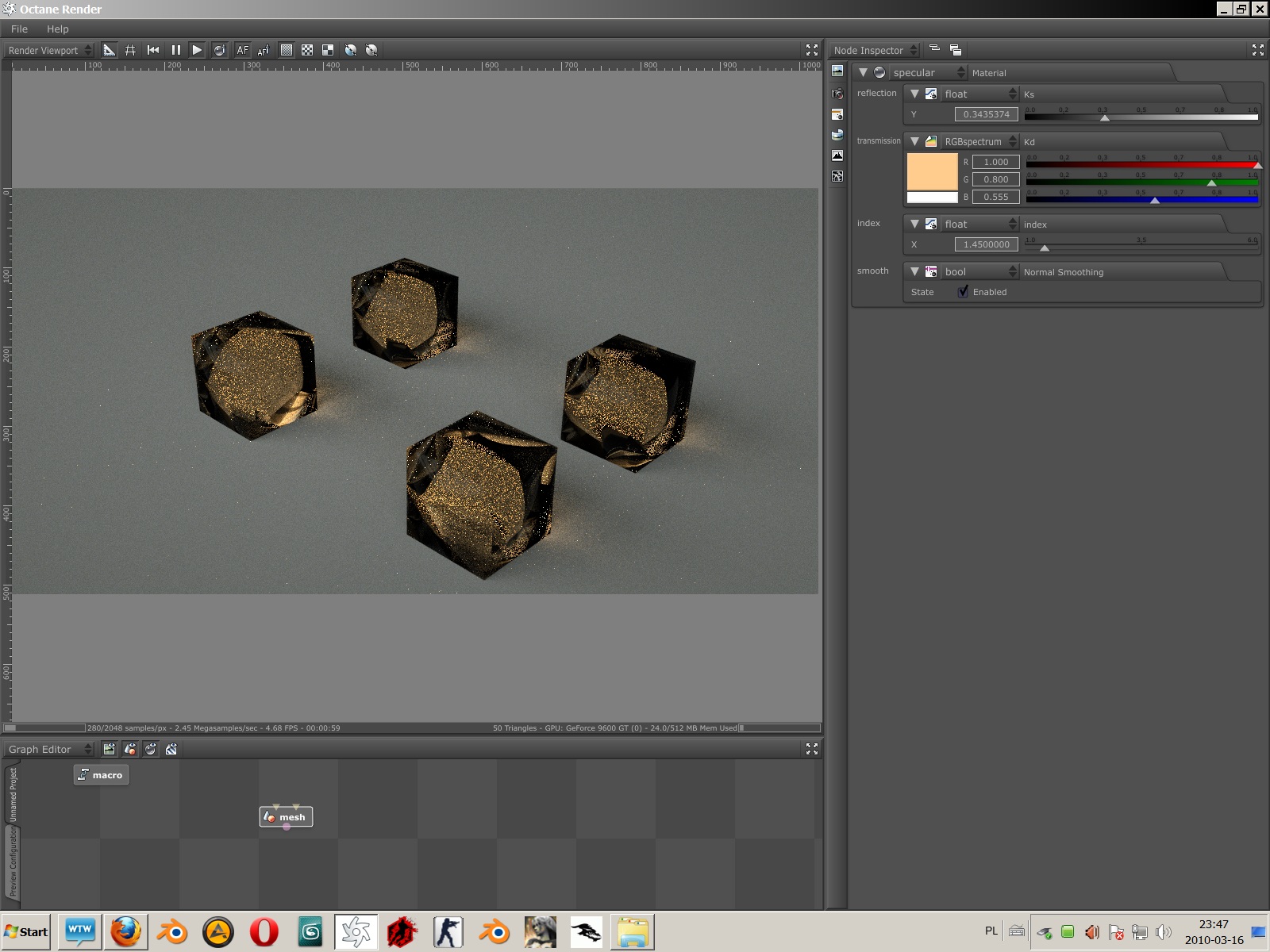

I can't do galss material in octane (working in blender 2.49b) becouse there are errors and it doesn't looks good (octane wersion 0.81a) and i don't know how to change transparency of the material. If you can you can make short tutorial how to made a realistic glass.

Colors will result in a tint of the material and black will absorb all lightrays.
What specific errors do you speak of ?
You change the transparency by adjusting the Kd value, which by default is a color. Set this to pure white will create a 100% transparent specular material.there are errors and it doesn't looks good (octane wersion 0.81a) and i don't know how to change transparency of the material. If you can you can make short tutorial how to made a realistic glass.

Hi, can you give us some screenshots to illustrate the problem?RUNNER wrote:I can't do galss material in octane (working in blender 2.49b) becouse there are errors and it doesn't looks good (octane wersion 0.81a) and i don't know how to change transparency of the material. If you can you can make short tutorial how to made a realistic glass.

Actually this is one place where the current manual differs from the beta. The beta calls the first two specular parameters 'Ks' and 'Kd', whereas the manual calls them 'specularity' and 'transmission'. I assume this small error has already been caught?MDkai wrote:You change the transparency by adjusting the Kd value, which by default is a color. Set this to pure white will create a 100% transparent specular material.

thwak wrote:Actually this is one place where the current manual differs from the beta. The beta calls the first two specular parameters 'Ks' and 'Kd', whereas the manual calls them 'specularity' and 'transmission'. I assume this small error has already been caught?MDkai wrote:You change the transparency by adjusting the Kd value, which by default is a color. Set this to pure white will create a 100% transparent specular material.

If you change the material from a glossy to a specular, it will retain the ks and kd descriptions. If you change from diffuse straight to specular, you will see the specularity and transmission descriptions as it should be. This appears to be a bug. I'll report it to Radiance.

Ah. Thanks Phil.PhilBo wrote:If you change the material from a glossy to a specular, it will retain the ks and kd descriptions. If you change from diffuse straight to specular, you will see the specularity and transmission descriptions as it should be. This appears to be a bug. I'll report it to Radiance.
