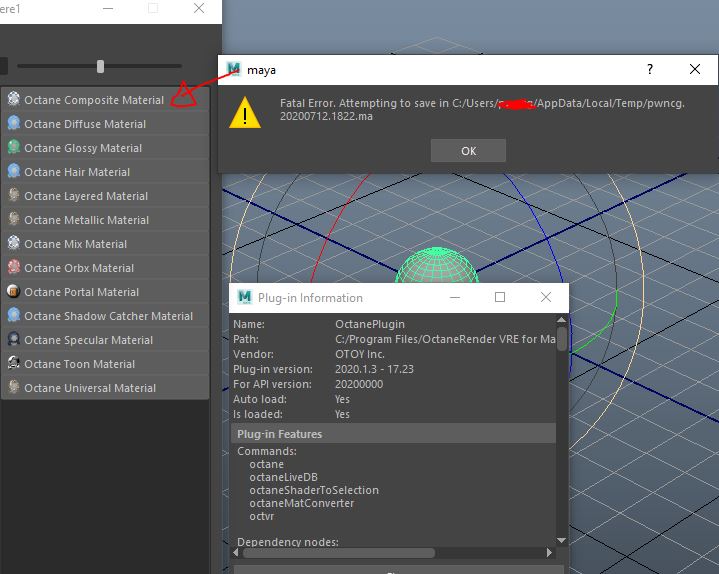

zurakan
Posts: 44
Joined: Fri Sep 27, 2013 7:13 am
i test Octane Composite Material Node
when create not maya is fatal error
maya 2020.2 and maya 2018.7 same error

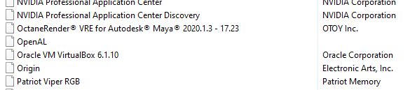

zurakan
Posts: 44
I only have this version on my pc still fatal error
I can use Octane Orbx material >> and use Composite material in side Orbx
Win7 Ultimate x64 xeon Core 40 / maya2Octane 1.20a , maya 2014SP4 & Octane 1.50,
128GB Ram, 4 x GTX Titan 6GB
JimStar
Posts: 3852
zurakan
I can't reproduce it, tried different Maya versions - no crashes...
Can you share the Maya dump files (it creates them in the Temp folder after every crash)?

JimStar
Posts: 3852
zurakan
Thanks for the dump-files.
This is some Autodesk's fluctuating bug (I can't reproduce it in any Maya versions), happening deeply in Maya's DependEngine.dll library's stacktrace.
Needs to be reported to Autodesk...
