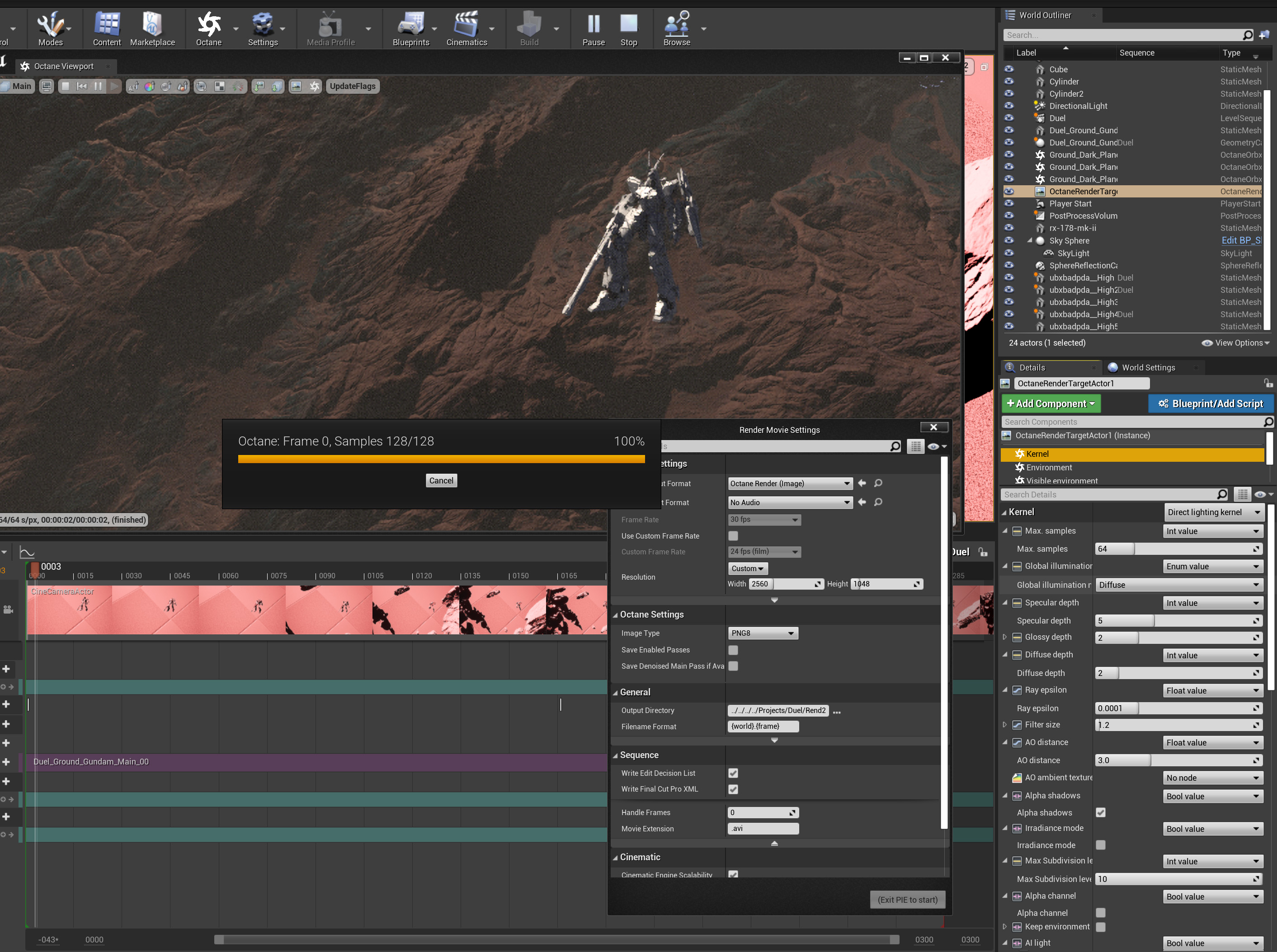

i just installed the new version.
chose 64 samples instead of the default 128, but the settings wont render.
changing kernel samples has no effect, its stuck on 128.
will try this in different scenes ofcourse.

did some more tries. after a few export tries the kernel settings do change but cant figure when.
maybe if i restart the octane engine completely but not sure.

When moving over into playmode, unreal does not always force a save. When this happens unreal will load in copy of the rendertarget with the old setting.
You can force it to save first by pressing the save button.
I have fixed this in the next build.
