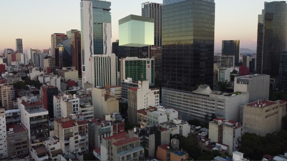

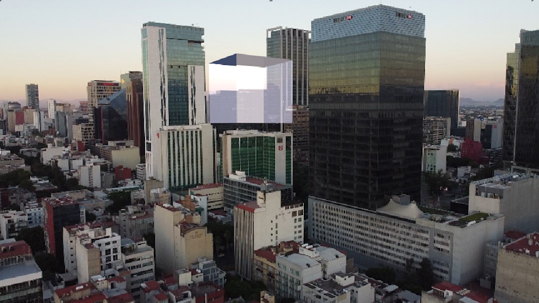

Is there any way for refractive (transmissive) materials to refract a background object?
I'm attaching two different images, one with the desired result and another with what I get with octane render (which refracts octane's daylight object)
Desired result with c4d's standard renderer (you can see buildings refracted):
Octane render refracting daylight object instead of background:

I've tried both using a native material for the background and an octane material.

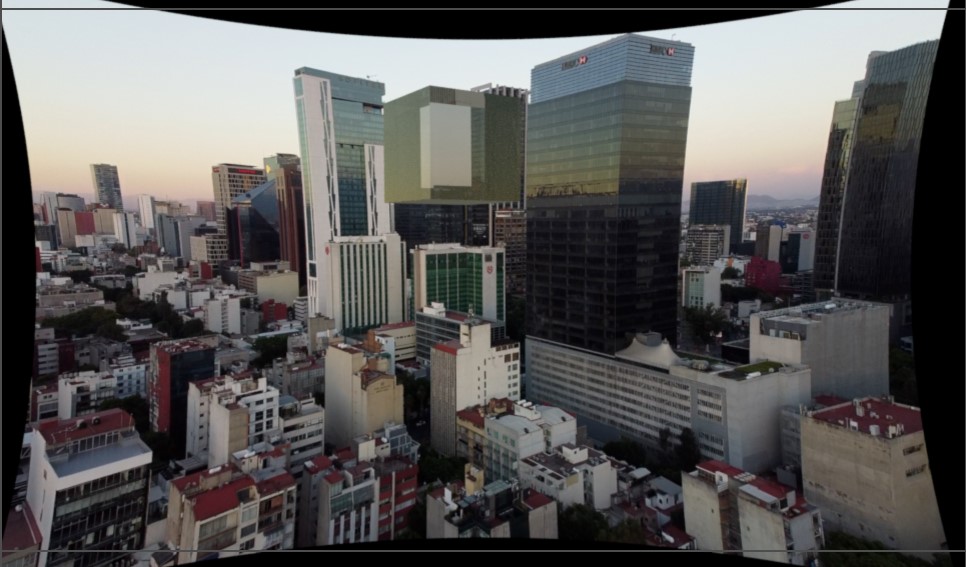

Thank you Beppe, I did that and it allowed the material to refract the texture environment node behind it, however using the texture enviroment node, my backplate projects into a sphere, distorting it, What I'm looking for is a solution where my backplate projects to a flat plane, with "frontal" projection and not reacting to camera movement, such as with c4d's background object. Is there anyway to achieve this ?
This is what I'm getting with your advice:
distorted
distorted
