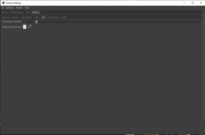

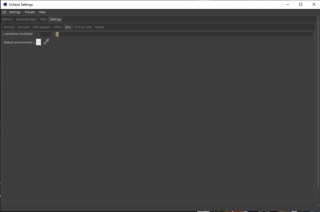

You can change the default environment color in Octane Setting > Setting > Env

galleon27 wrote:You can change the default environment color in Octane Setting > Setting > Env
Yes, note that it's a scene specific parameter, saved to the scene. And will not change on a different PC

Great, thanks for the tip!
