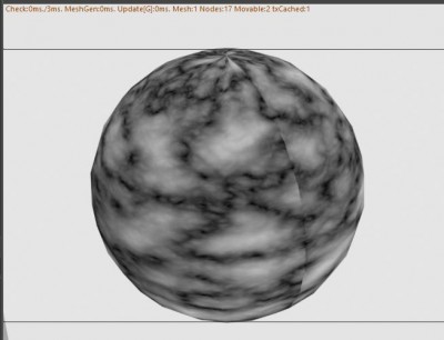

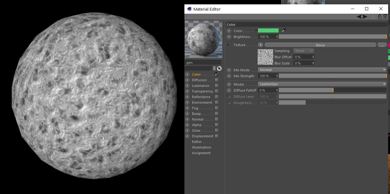

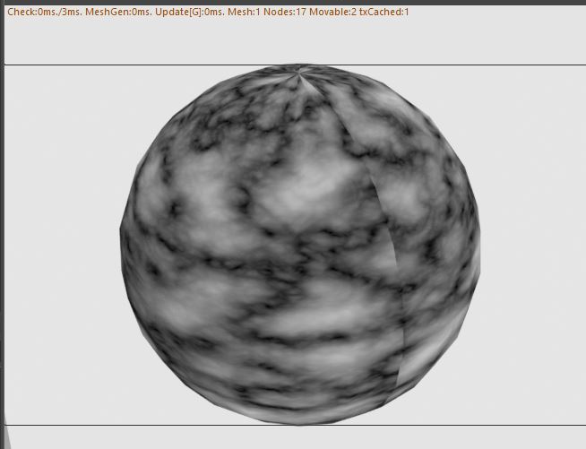

Hi, I was wondering if there was a simple method to achieve seamless procedural textures, like there is in the standard/physical render in Cinema 4D. For example:
Here's a version in Octane:
A similar question has been posted here and I also found this solution, but it seems a bit complicated
The nearest I can get is a tileable image texture, but that creates an ugly top and bottom.

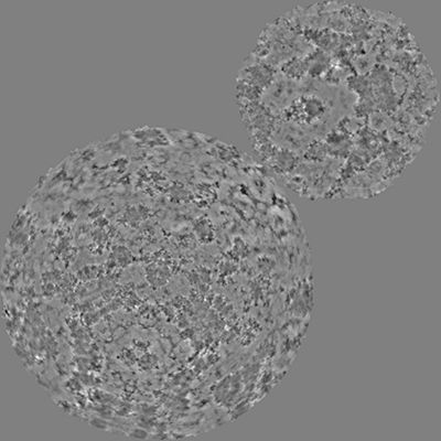

I found a tutorial from Otoy on doing it here, which works perfectly, but that required creating a spherical texture in Zbrush:
Any help appreciated in achieving this, I'll happily go down the Zbrush route, but I wanted to check there wasn't a better way

nejck wrote:Perhaps a Tri-Planar node would help. Unless you need it to be precisely unwrapped :)
thanks for your reply. Would the Tri-planer method be as described here?: https://inlifethrill.com/seamless-displ ... cinema-4d/
I would like it to be as evenly distributed and seamless as the Cinema Standard/Physical render. I guess the only way would be using an unwrapped map like this?
But then I would be dealing with quite large maps

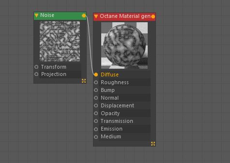

aoktar wrote:you can use c4d noises if you're on 2020

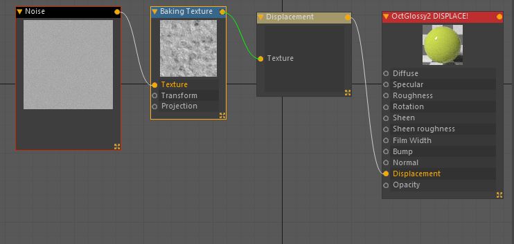

Thanks aoktar, that works for Diffuse maps now!:

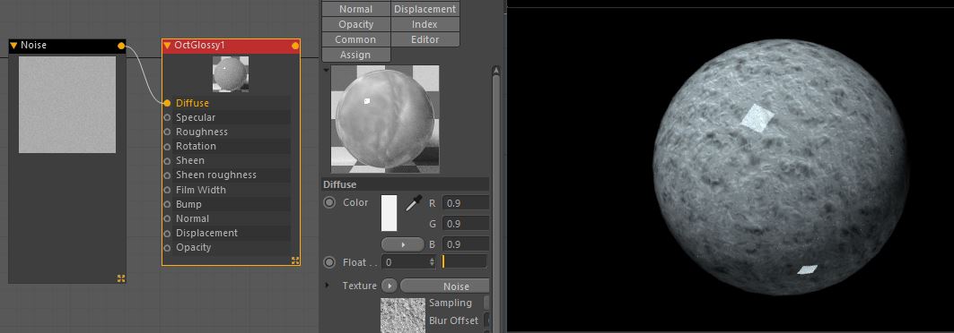

I'm trying to use it for a displacement map now:
But this method crashes C4D. Am I doing it correctly?
Posts: 16068
Location: Türkiye
atoyuser1 wrote:
aoktar wrote: I'm trying to use it for a displacement map now:
you'll still get tilability with baking node. Also it's not crashing but calculating repeately. I'm working on fix for the issue.
atoyuser1
Posts: 212
Joined: Sat May 02, 2020 1:10 pm
aoktar wrote:
thanks. Is there a way to avoid tiling in displacement ?
