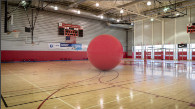

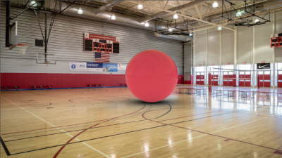

So It seemed like a simple thing. I have this image of a basketball court.
And I wanted to put a reflective sphere on the court. So I need the sphere to reflect the environment, but also reflect the court it was sitting on. And we should see the ball reflected into the court.
I did all of this rough, just to get the workflow for an upcoming project so I can figure out the layers I need to make it work with the animation. So I made a reflective floor which I camera projected the background image on. I also made a Visible Environment to get the scene reflections onto to the sphere. Got it all to work and look decent enough in Octane.
I also made the floor mask away so that I could blend the beauty if I wanted to.
So I was able to use this render out beauty and composite fine in After effects, but I wanted more control over each pass and didnt want to use that whole floor. So I wanted the ball on its own, and then be able to put in the shadow and reflection separately so that the floor was the real floor. This was where the problem was. Using the Render Layer way, the black shadows pass and the reflection layer were both totally different when composited. Even just using a Shadow Catcher was giving me a different result, becuase it wasnt a reflective floor.

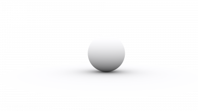

This is what the shadow catcher looked like.

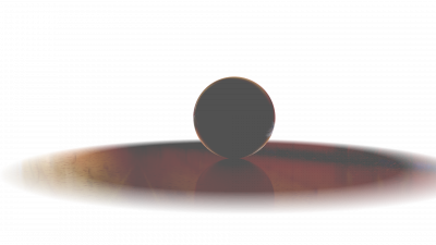

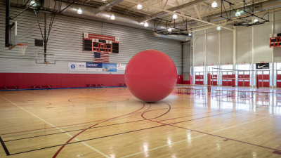

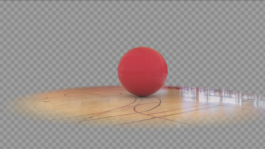

But after some playing around with the beauty passes the best result I got was rendering a Beauty pass, Reflection, Shadow and a Cryptomatte pass and was able to composite it to work.
Ball with matte (normal matted with Cryptomatte, some color correction)
Reflection (Screen, some color correction)
Shadow (Multiply)
BKG image
Final Comp
Again, Lighting wasnt perfect, it was just a test to get the workflow to work and I feel like it did. What I do wish Is that I didnt need the full floor reflection, because its getting unnecessary reflections from the environment I added. But I wasnt able to use just the Render Layer reflection pass. It didnt look right, especially with the wrong shadow as well. Anyway hope this helps.
