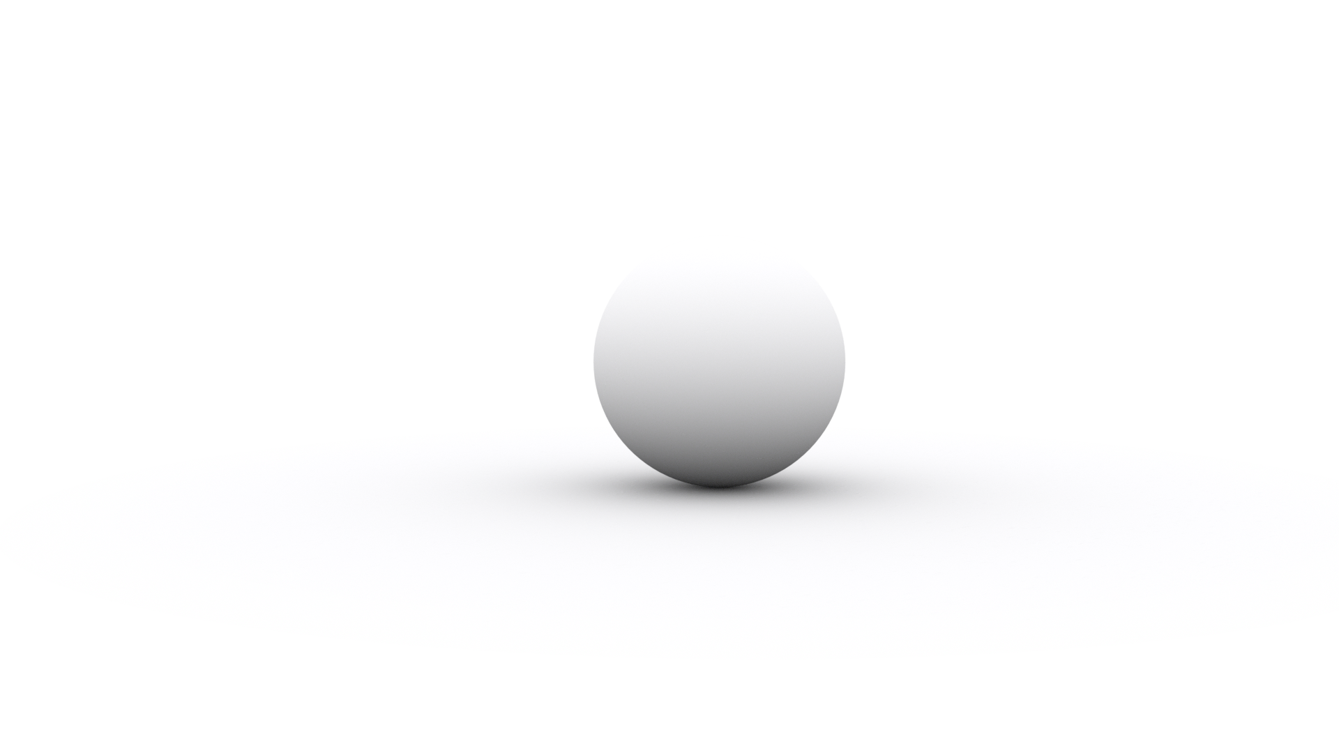

This is what the shadow catcher looked like.

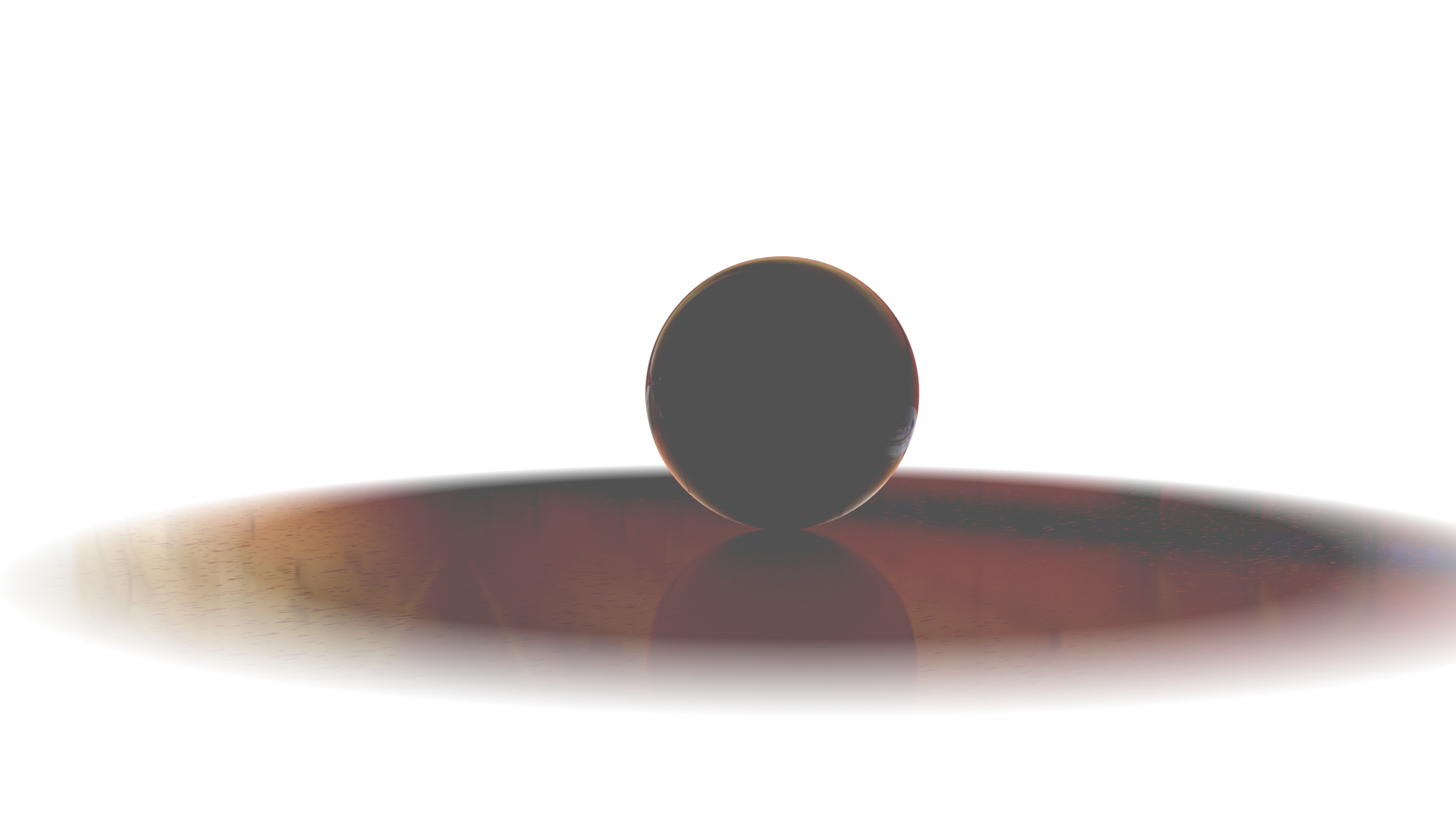

But after some playing around with the beauty passes the best result I got was rendering a Beauty pass, Reflection, Shadow and a Cryptomatte pass and was able to composite it to work.
Ball with matte (normal matted with Cryptomatte, some color correction)
Reflection (Screen, some color correction)
