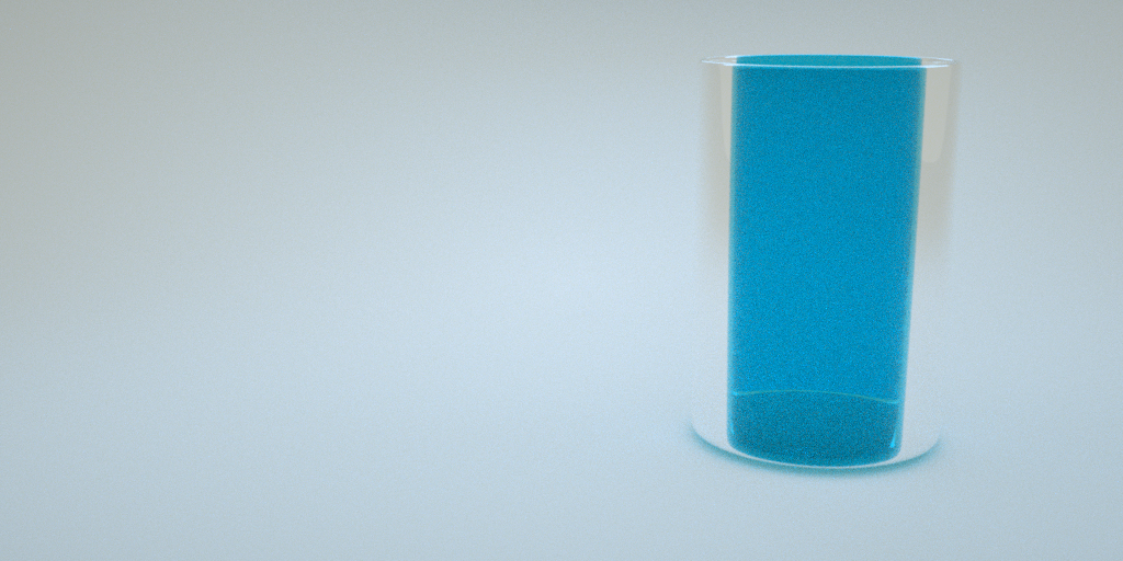

Specular like a bad thing.

I Don`t know what is it. I try any drivers, and builds of octane.
This specular have chrome edge. What is it?
Specular is default. 1.45 IOR, if do high chrome grow to center.
I use Maya and last exporter plugin.
Just maybe size in maya very high\little ?
I do this in cm, but in octane in preferens meter to meter. If change to cm to meter, in octane my object will be far from camera.

Hatak wrote:I Don`t know what is it. I try any drivers, and builds of octane.
Thx.
PS.
Replace topic in commercial support. Thx.
The normals are pointing inwards (/are inverted) which is the reason, why you get total reflection at a specific viewing angle. Invert the normals and export again. After that it should work correctly.
