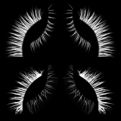

not sure the reason, Does any of you having the same issues? I put the eyeslahes in opacity as usual but it doesnt work for some reason. Trying to find where am i doing wrong. and my ray epilson in lowest level.. so Any idea what i need to change ?

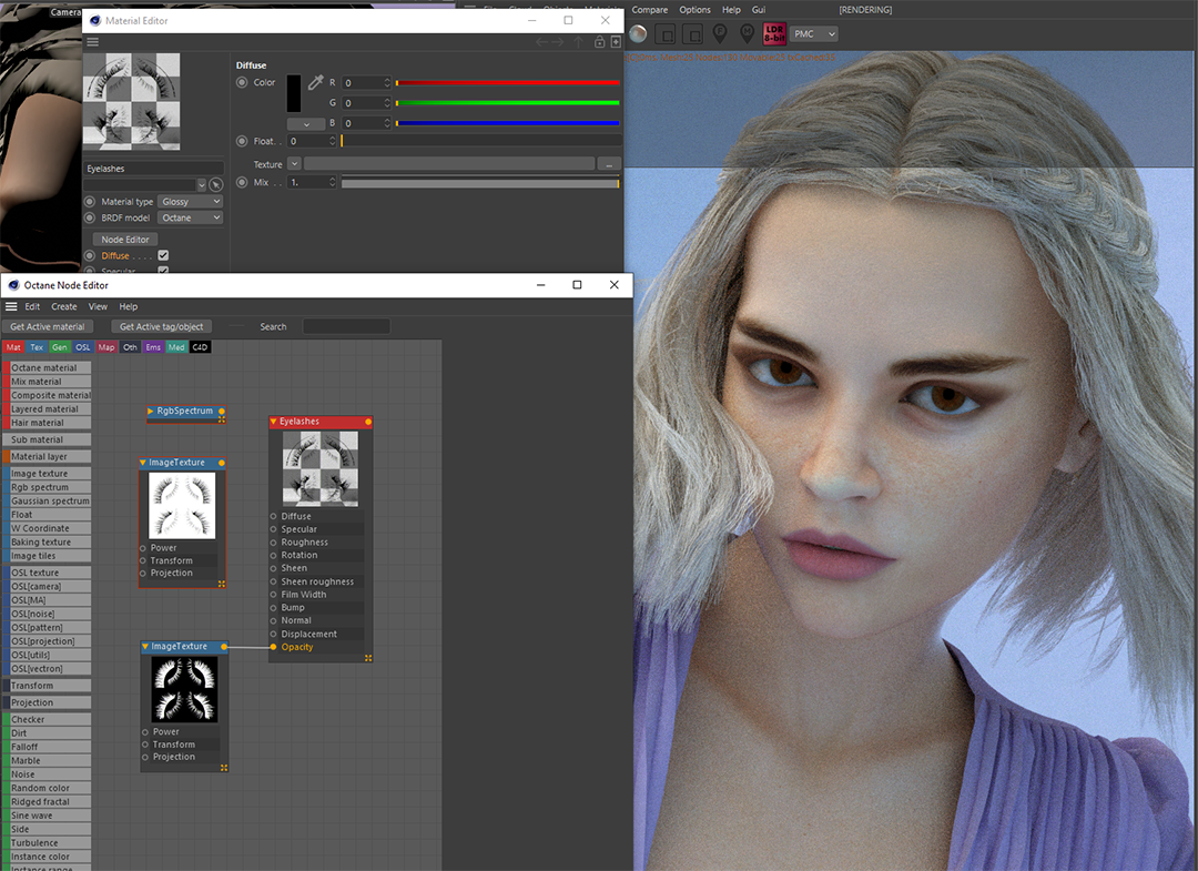

Thanks for the reply. I dont know what you mean a stripped down scene file? and not sure if it will upload on here but i attached an image what i mean. This is what i have been always doing for eyelashes.
I also tried to connect black color for the diffuse but nothing changes. On the shader i see the eyelashes but not on the model.

Stripped down, as in a scene where everything has been removed except for the elements that are the problem, in this case, just the geometry of the eyelashes and the texture you are applying to them, and the basic scene render settings you are using. That screen shot doesn't really tell enough about what else is going on to offer any useful suggestions.

checked now! You extremely stripped down your scene. At least add some textures.pinarer wrote:looks like some of you downloaded the file, so any idea why the eyelashes don't show up?
As I could see from your setup, there's nothing special. If you didn't delete some critical textures.
Yes, there's something funky going on with the eyelash geometry, I think, not the material, but I'm a bit to busy at the moment to dig into it. As Ahmet mentioned, your actual opacity texture was not included, so I knocked one together based on your screenshot. I'll try to follow up on this later this afternoon.pinarer wrote:looks like some of you downloaded the file, so any idea why the eyelashes don't show up?
Your uv mapping projection is set to spherical. Set it to uv map
