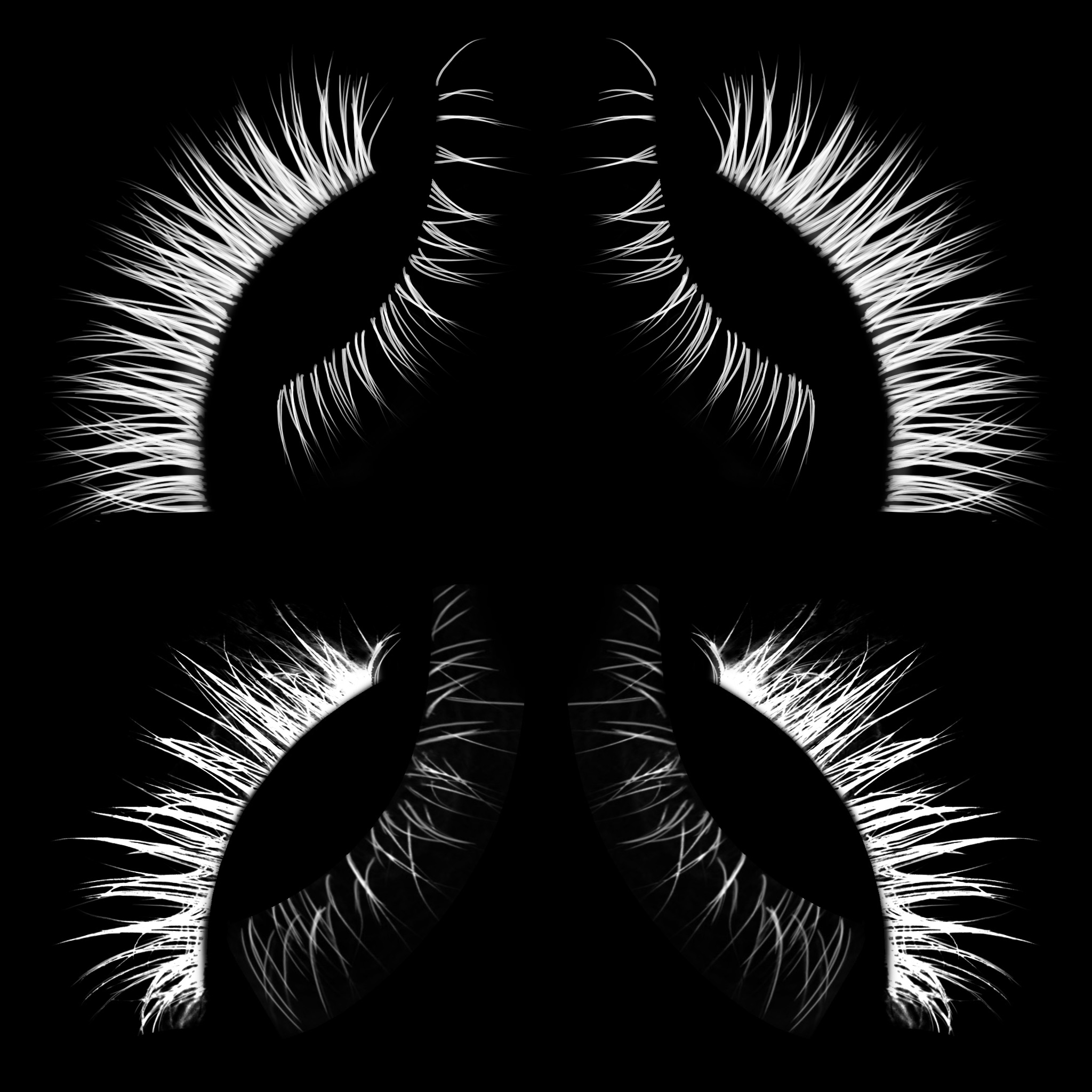

as frankmci said, i deleted everything and just left the eyelashes, i added here my opacity file if you can not find in there

Your uv mapping projection is set to spherical. Set it to uv map
