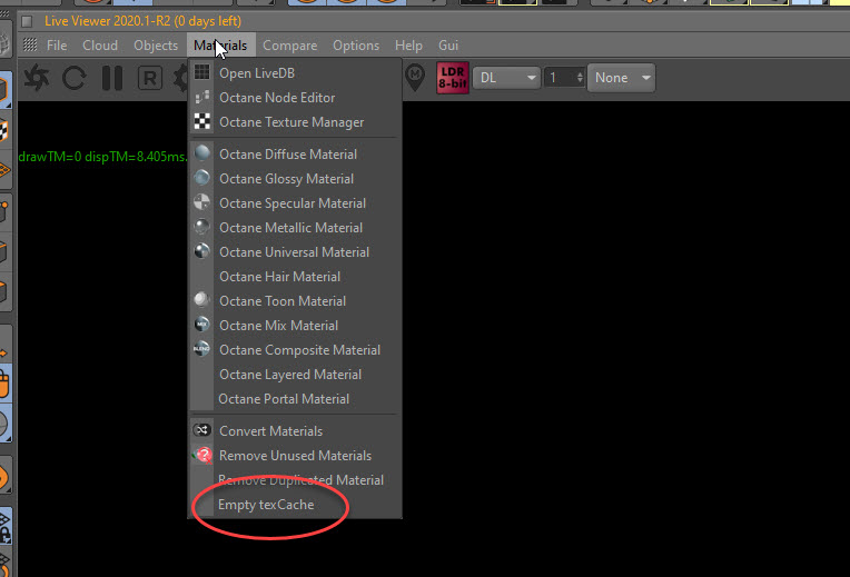

Getting lots of crashes lately. For example, when the live viewer is rendering, if I switch off and on octane lights (green tick), it simply crashes and I get the pop up saying this plugin is crashed, find the report here etc. And my machine is no ordinary. It is quite high-end.
System Info:
RTX 3090
i7 10700
32 GB Ram
Windows 10
Octane version: 2020.2.3-R3
Cinema 4D R21
I tried emptying the texture cache but no avail. Generally since I started my subscription with this 2020 version, many actions can cause crash making me feel like this version is quite unstable.
Please advise.
Thanks!
