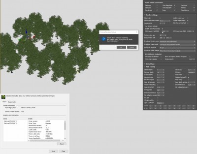

Hi guys,
in light of current CUDA errors you reported, could you please try as follow:
1 Updates windows 10 up to at least build.
2 Right click the Start button and select Control Panel.
3 Make your way to System and Security.
4 Click System.
5 Click Advanced system settings from the left sidebar.
6 Select the Hardware tab.
7 Press the Device Installation Settings button.
8 Choose No, and then press the Save Changes button.
9 Unistall the Nvidia drivers using DDU Nvidia unistaller drivers safe mode unistall - windows safe mode https://support.microsoft.com/it-it/hel ... -safe-mode
10A - install this 442.92 studio Nvidia driver standard mode (not DHC) http://us.download.nvidia.com/Windows/4 ... d-whql.exe
please doesn't install GeForce Experience and make a clean installation.
or
10B - install this 442.50 game ready Nvidia driver standard mode (not DHC) http://us.download.nvidia.com/Windows/4 ... l-whql.exe
To start your test, please active the Out-of-core then set the head room to 512MB, parallel sample to 2 and max tiles to 4.
Let me hear from you.

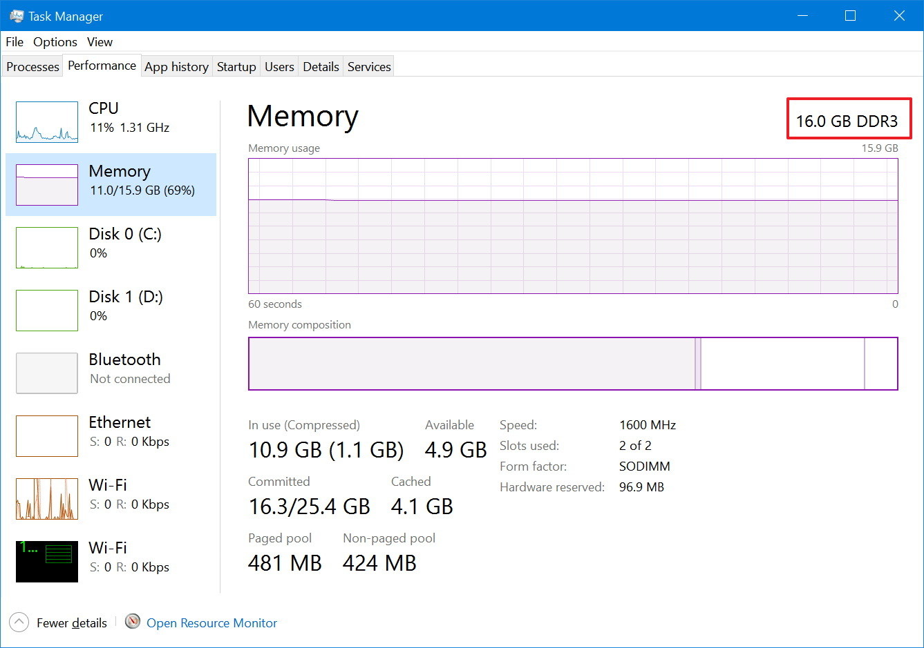

paride4331
Posts: 3979
Hi samsue,
me too 18363.778, I'm running smooth with 442.92.
Could you check how many memory free availble when the render is starting please?
Regards
Paride
samsue
Posts: 393
Hi :oops:
It definitely works, probably my error was generated by lack of memory. ( even though i have 128 gb )

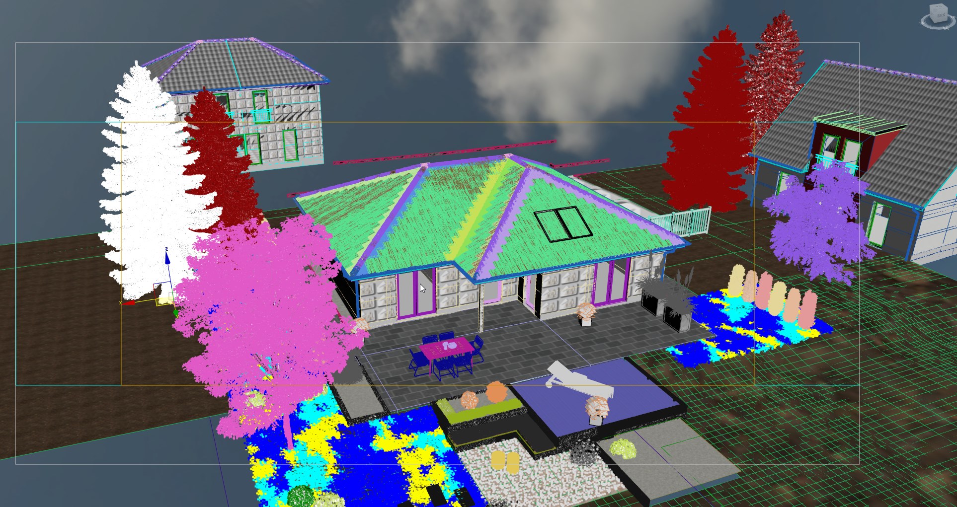

paride4331
Posts: 3979
Hi samsue,
have you any big geometry group in your scene?
Regards
Paride
samsue
Posts: 393
Hi paride4331,
I found 4 textures with 8k ...
After convert to 4k seems to be working with GPU head room 512, with 100 I have the same error as before. If wou whant, i can send you my scene.
the biggest obeject I have on the scene, is 1.6 million polys
paride4331
Posts: 3979
samsue wrote:Hi paride4331,
Hi samsue,
before to sharing your scene, could you try (using 8k textures) to ungroup all of your group in the scene, then test with 512MB headroom or 1024MB?
Regards
Paride
