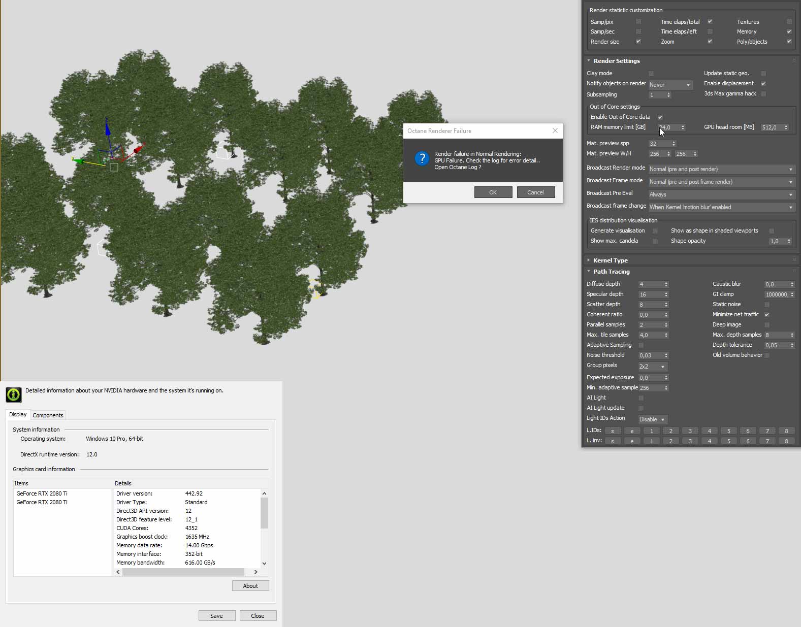

Hi guys,
in light of current CUDA errors you reported, could you please try as follow:
1 Updates windows 10 up to at least build.
2 Right click the Start button and select Control Panel.
3 Make your way to System and Security.
4 Click System.
5 Click Advanced system settings from the left sidebar.
6 Select the Hardware tab.
7 Press the Device Installation Settings button.
8 Choose No, and then press the Save Changes button.
9 Unistall the Nvidia drivers using DDU Nvidia unistaller drivers safe mode unistall - windows safe mode https://support.microsoft.com/it-it/hel ... -safe-mode
10A - install this 442.92 studio Nvidia driver standard mode (not DHC) http://us.download.nvidia.com/Windows/4 ... d-whql.exe
please doesn't install GeForce Experience and make a clean installation.
or
10B - install this 442.50 game ready Nvidia driver standard mode (not DHC) http://us.download.nvidia.com/Windows/4 ... l-whql.exe
To start your test, please active the Out-of-core then set the head room to 512MB, parallel sample to 2 and max tiles to 4.
Let me hear from you.

Hi
It definitely works, probably my error was generated by lack of memory. ( even though i have 128 gb )
I can reproduce a error in a scene;
device 1: failed to upload data texture 34 '0:__data31__'
**all texture 4096K
https://www.youtube.com/watch?v=EfBHt_bMhiM
**all texture 4096K

Hi samsue,
have you any big geometry group in your scene?
Regards
Paride
Regards
Paride

Hi samsue,samsue wrote:Hi paride4331,
I found 4 textures with 8k ...
After convert to 4k seems to be working with GPU head room 512, with 100 I have the same error as before. If wou whant, i can send you my scene.
the biggest obeject I have on the scene, is 1.6 million polys
before to sharing your scene, could you try (using 8k textures) to ungroup all of your group in the scene, then test with 512MB headroom or 1024MB?
Regards
Paride
