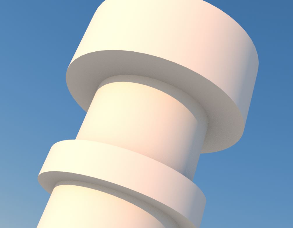

All object visible :

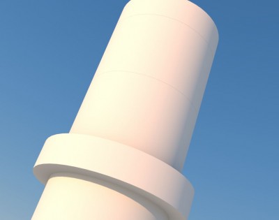

Hide object with object layer visibility disable ( black artifact ) :

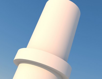

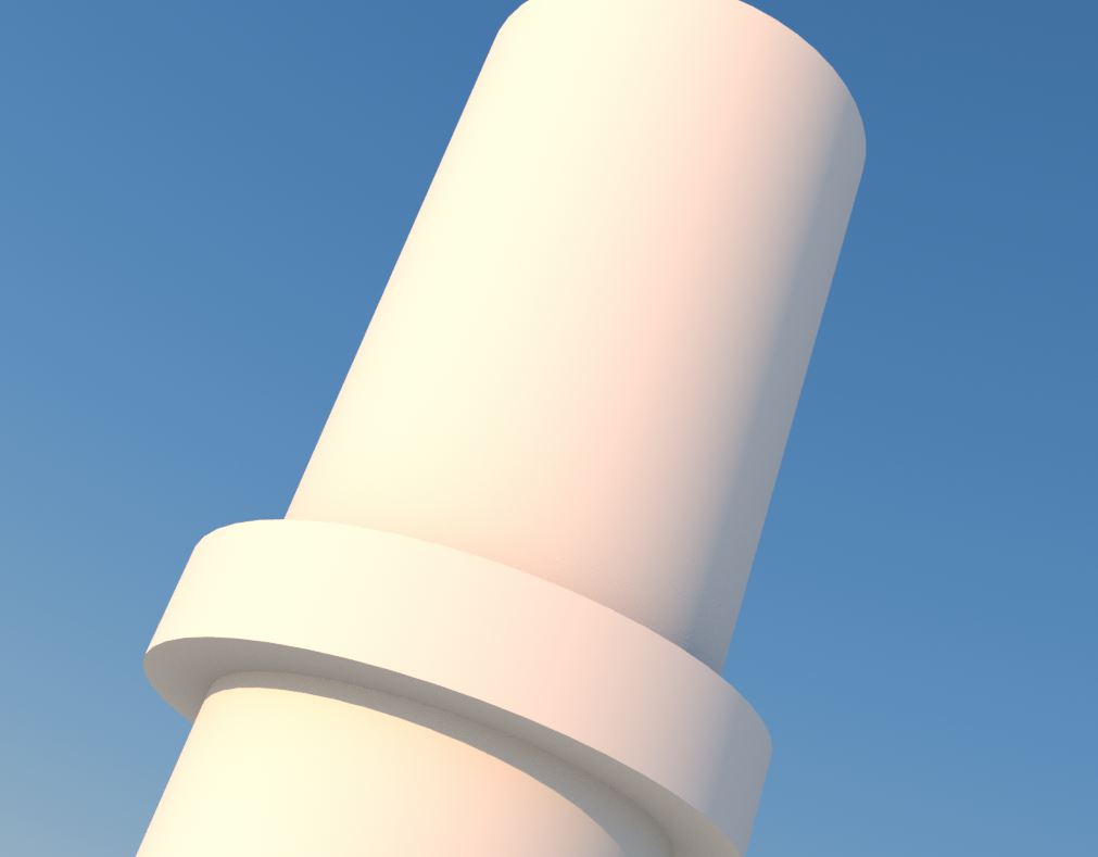

Hide object by disconneting it from the render group ( object perfectly invisible ) :

in my exemple i am able to solve the issue by using a very very small ray epsilon, but if someone can explain me what happen in the background , i would happy to understand .

Looks like our old friend, Ray Epsilon, is the culprit. At that scale, you need to drop it down another decimal place. Odd that the geometry of a hidden layer still has influence, but tweaking that setting will eliminate the artifact.

The reason is because the hidden object intersect with another object - or is too close to it.
You can turn "Ray Epsilon" down as a quick fix, but I will not recommend that as it will create shadow artifacts in your scene.
Another quick fix is to scale your scene way up which might fix it but can create other problems.
Best fix is not to have object intersect with each other. Or move them a little bit away from each other.
You will also have the same problem in a very big way if you use displacement maps. Yes, it is very annoying and maybe in the future Otoy can fix this.
