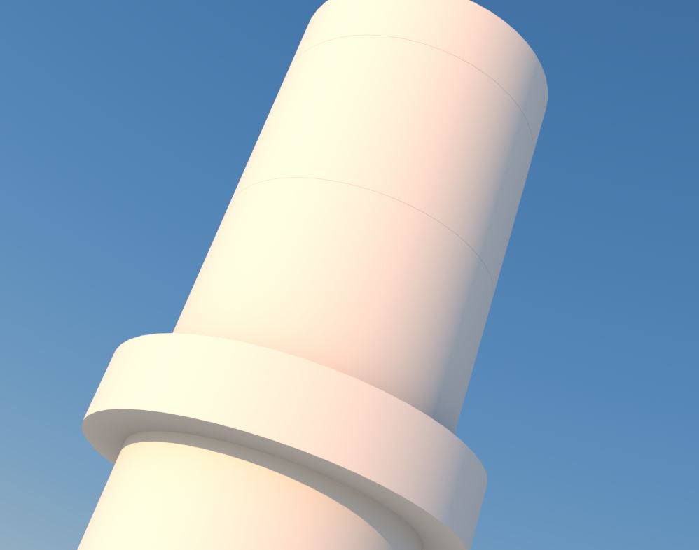

Hi guys.
I have 3 cylinder overlaped, each object has his own object layer.
when i set on one of those object
- general visibility to 0
- camera visibility OFF
- shadow visibility OFF
I was expecting that the object become totaly invisible in the rendering.
But, i have a black artifact on object on every area where the hidden object overlap with the visible object.
How could i get rid of those artifact in order to get the exact same thing i would get if i disconnect the object from the rendering group.
All object visible :
Hide object with object layer visibility disable ( black artifact ) :
Hide object by disconneting it from the render group ( object perfectly invisible ) :
Thanks for your lights !
Cheers
E

Hi beppe, Thanks for your answer.
The scale of the object is 8cm x 19cm x 8cm.
overlap_artifact_01.orbx
(158.78 KiB) Downloaded 129 times
I have attach the scene just in case.
It' s an octane 2019 scene by the way.
Cheers
E

Looks like our old friend, Ray Epsilon, is the culprit. At that scale, you need to drop it down another decimal place. Odd that the geometry of a hidden layer still has influence, but tweaking that setting will eliminate the artifact.
