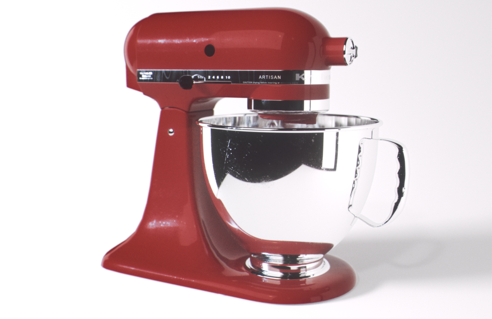

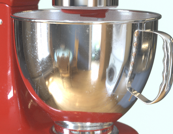

Hi, using C4D plugin, I've notice that if I try to catch shadows the HDRI reflections seems to shift causing incorrect/offset reflections.
This is repeatable when using either a matte material ("shadow catcher" under common tab) or using the render layer system (with the shadow catcher material).
The object catching the shadows is a simple plane (though it happens with any geometry including a cube or C4D floor object)

I think I've figured it out though... it's bringing the "floor" of the HDRI up to meet the contact shadow. Without the shadow catcher material, the object is in the centre of the HDRI.
Do you know if there's a way to stop that behaviour?

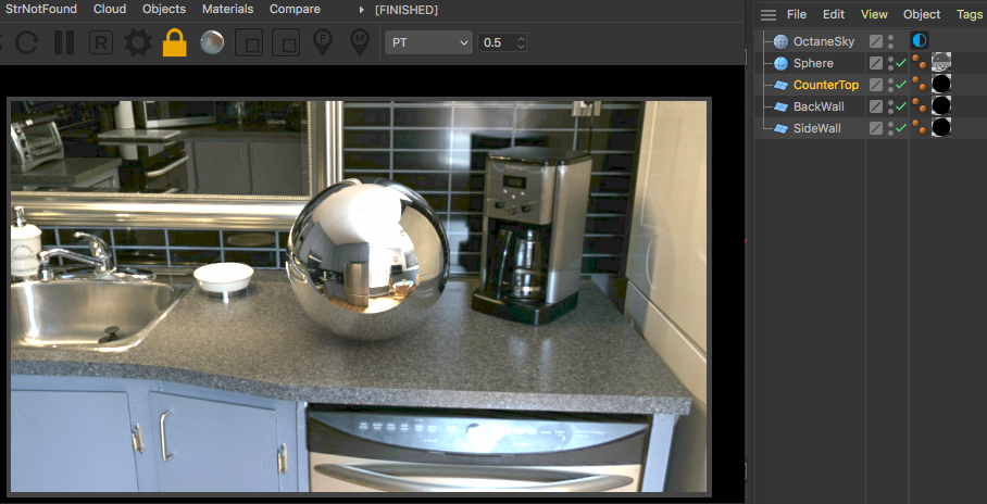

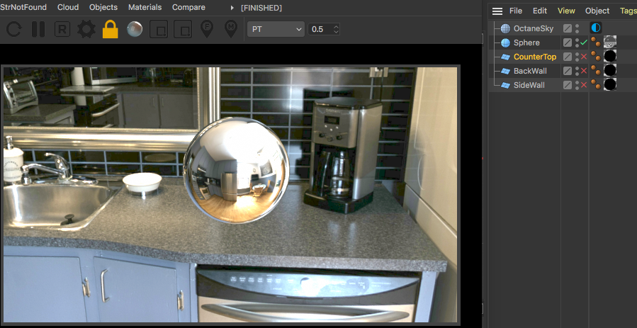

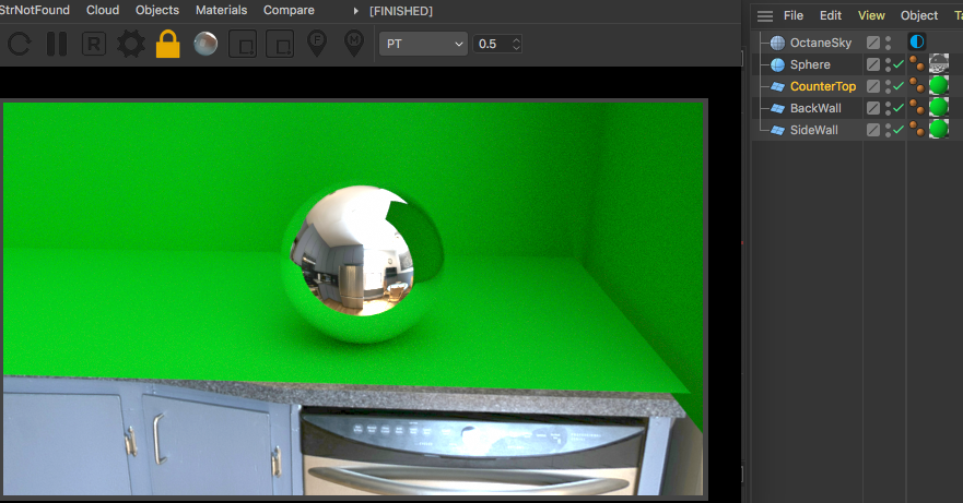

Oh, ok, I misunderstood what you were talking about. In the two images you posted, the reflected environment changes from having the window, table, chairs and doorway look pretty far away to looking much closer. That shouldn't happen, and it does not happen for me in the shared scene you uploaded. Yes, the shadow catcher does show up in the reflections as if there is geometry that more or less matches the environment there, and as far as I know that is intended. This makes the reflections more accurate, as various parts of the environment should be changed/occluded, as you can see in the renders below. As far as I know, there's no native way to disable the reflection aspect of ShadowCatcher enabled materials.nomojosh wrote:I think I've figured it out though... it's bringing the "floor" of the HDRI up to meet the contact shadow. Without the shadow catcher material, the object is in the centre of the HDRI.

Off the top of my head, if you want a shadow catcher but not have the shadowcatcher influence the reflections, I think you'll need do it in passes and comp them in post. I could very well be missing something, though. Maybe someone else has a good suggestion.
