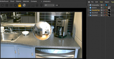

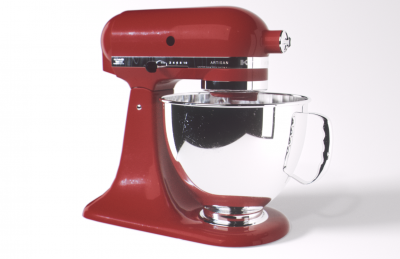

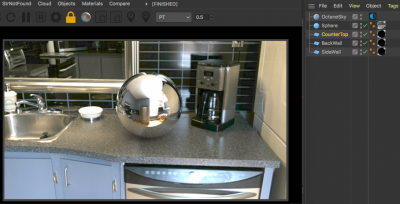

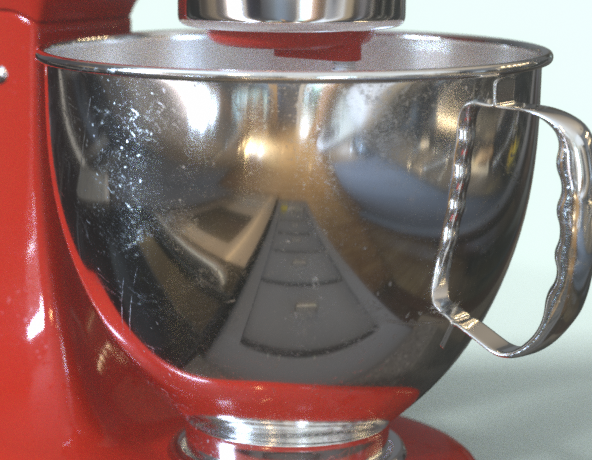

Hi, using C4D plugin, I've notice that if I try to catch shadows the HDRI reflections seems to shift causing incorrect/offset reflections.
This is repeatable when using either a matte material ("shadow catcher" under common tab) or using the render layer system (with the shadow catcher material).
The object catching the shadows is a simple plane (though it happens with any geometry including a cube or C4D floor object)
incorrect reflection

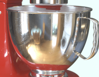

Below are the correct reflections when no shadow catching material is applied or the floor object is hidden from camera.
correct reflection
correct reflection
Any idea why this happens?

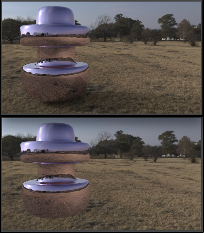

Oh, ok, I misunderstood what you were talking about. In the two images you posted, the reflected environment changes from having the window, table, chairs and doorway look pretty far away to looking much closer. That shouldn't happen, and it does not happen for me in the shared scene you uploaded. Yes, the shadow catcher does show up in the reflections as if there is geometry that more or less matches the environment there, and as far as I know that is intended. This makes the reflections more accurate, as various parts of the environment should be changed/occluded, as you can see in the renders below. As far as I know, there's no native way to disable the reflection aspect of ShadowCatcher enabled materials.

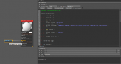

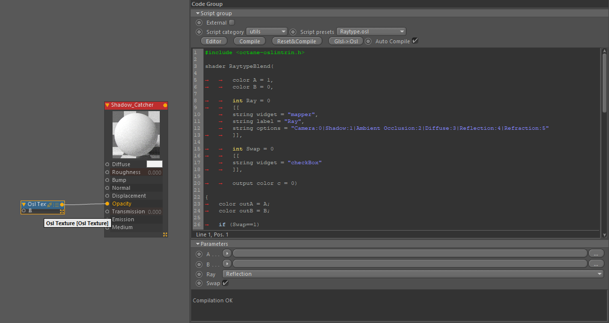

Thanks for the reply. I managed to get around it using an OSL node in the opacity channel of the shadow catching material (it was mentioned in another topic on here recently).
It meant I could use render layers and remove the shadow catching geometry from the reflections.
In production, I image we'd actually sit it on some geometry, but this resolve the issue I had here which is fine for look dev.
I can see why the shadow catcher moving the HDRI would be useful if you have a large open expanse, such as a car in a field. You'd want the car to appear to be in contact with the ground so it makes sense.
