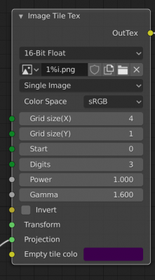

I'm trying to get UDIM Textures in Octane and Blender 2.82 (RC2_21.4) working.
but somehow it doesn't work. I have already tried "image tile tex". But I don't understand the workflow. :?: :?

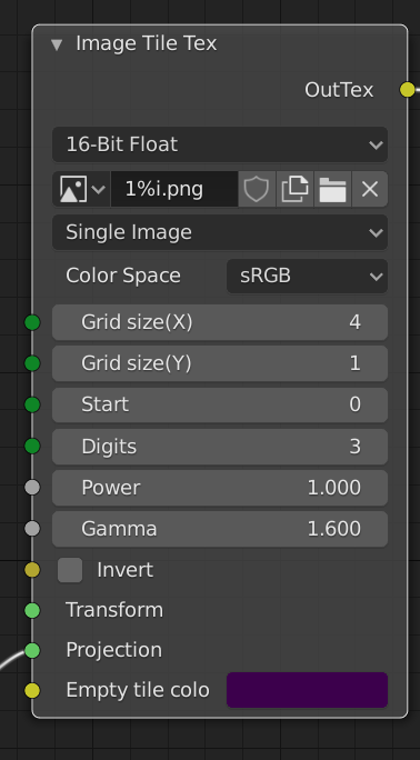

It seems like there's still some problem with UDIM/Image Tile (re: viewtopic.php?f=114&t=73110&p=372038#p372038 )
To get yours to work I had to change the "name" of the Image Data (in Blender) to 1%i.png and change the number of digits to 3
(If you put just %i.png and 4 digits, it will look for files named 0001.png, 0002.png etc)

@ChrisH
renaming the PNG should be the solution. Thanks for your help
linograndiotoy
Posts: 1536
Yes, that's the correct solution.
