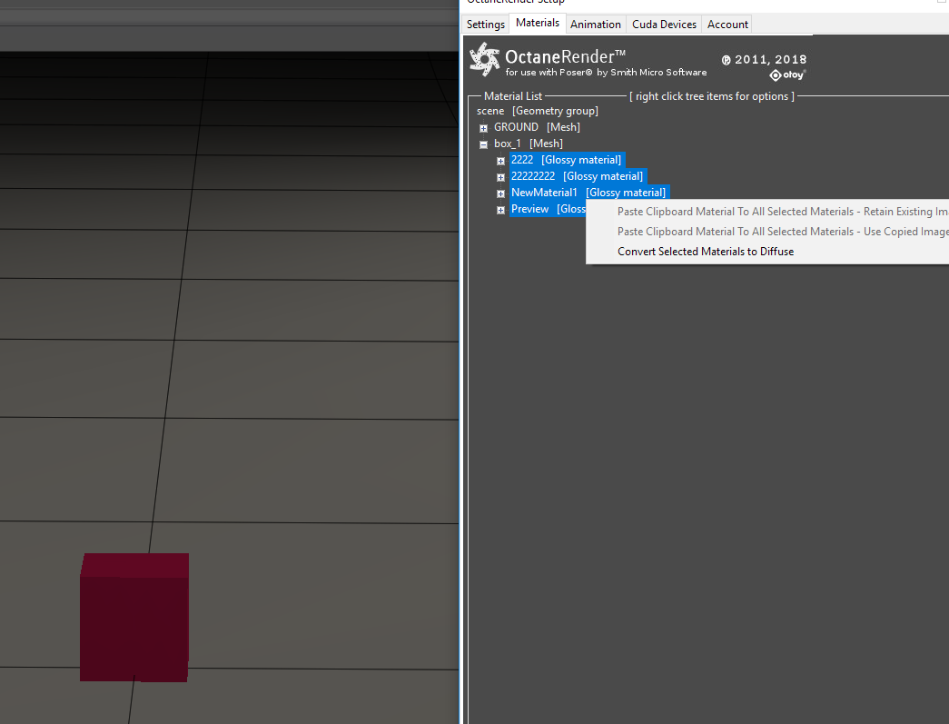

When I hold down the shift or control button to select multiple material nodes and right-click. I only can change them all to diffuse and not any other material node, like Toon, Glossy, etc.
Unfortunately opening this function up to convert the material to any material type is not as simple as it sounds. You can control the material type that a Poser material is converted to in OctaneDefaults.py (the GLOSSY_DIFFUSE_RATIO parameter). In addition to this, Poser materials with a "Physical Material" will be converted to Universal materials. I would have thought the Toon material would not be usable, as it really needs the Toon Lights, which the Poser plugin does not support.
