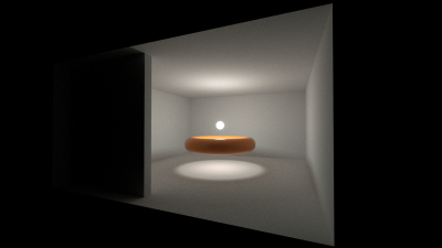

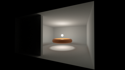

I've made a simple test in Blender and Spectron Lights are definitely less noisy than Mesh Lights.
100 samples in both cases.
Mesh Light:
Spectron Light:
Mesh Light:
Spectron Light:

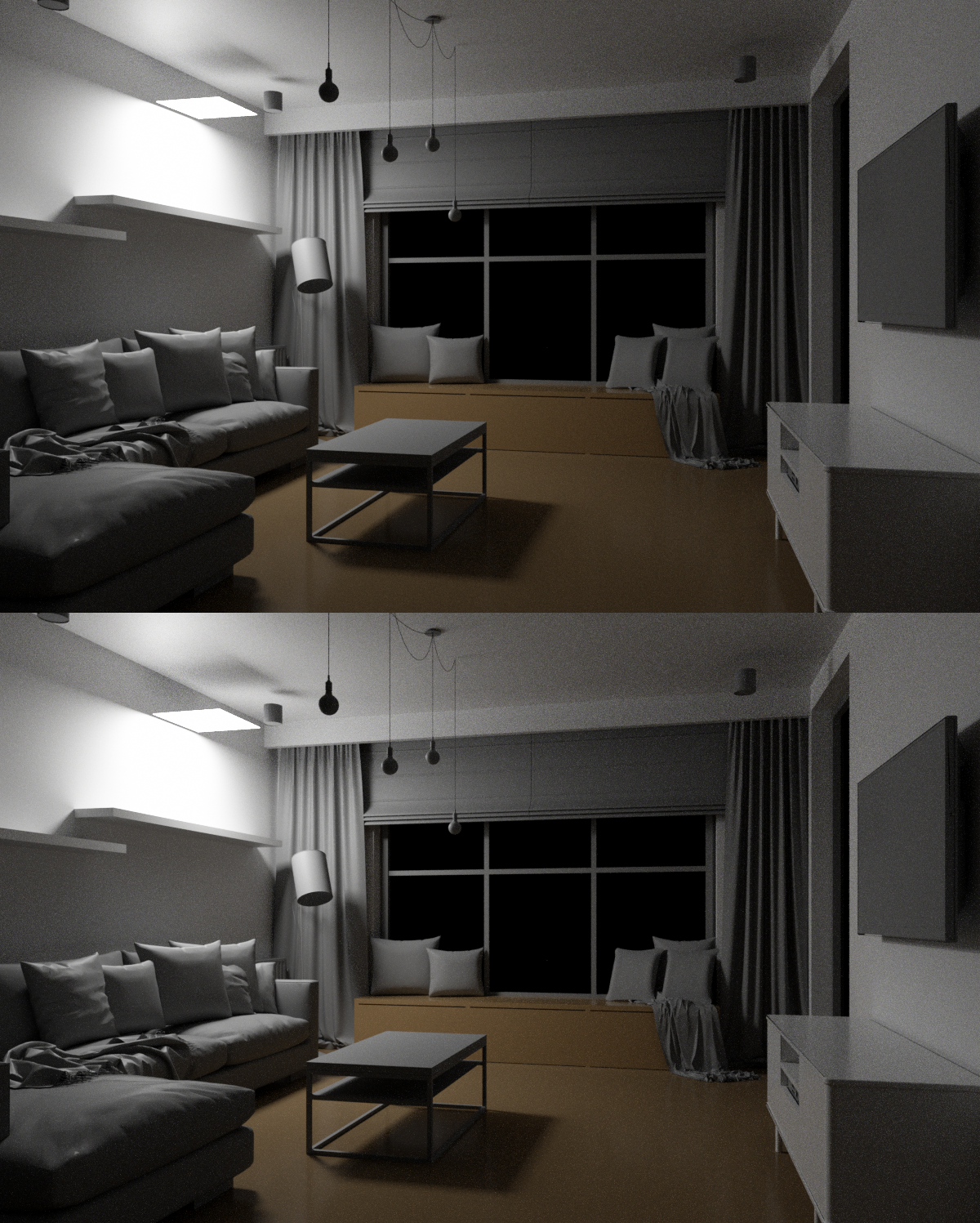

Lino, have you tried more complex scenes?linograndiotoy wrote:I've made a simple test in Blender and Spectron Lights are definitely less noisy than Mesh Lights.
Here is an example. Both with 1000 samples. Top render is with spectron, bottom with normal light:
