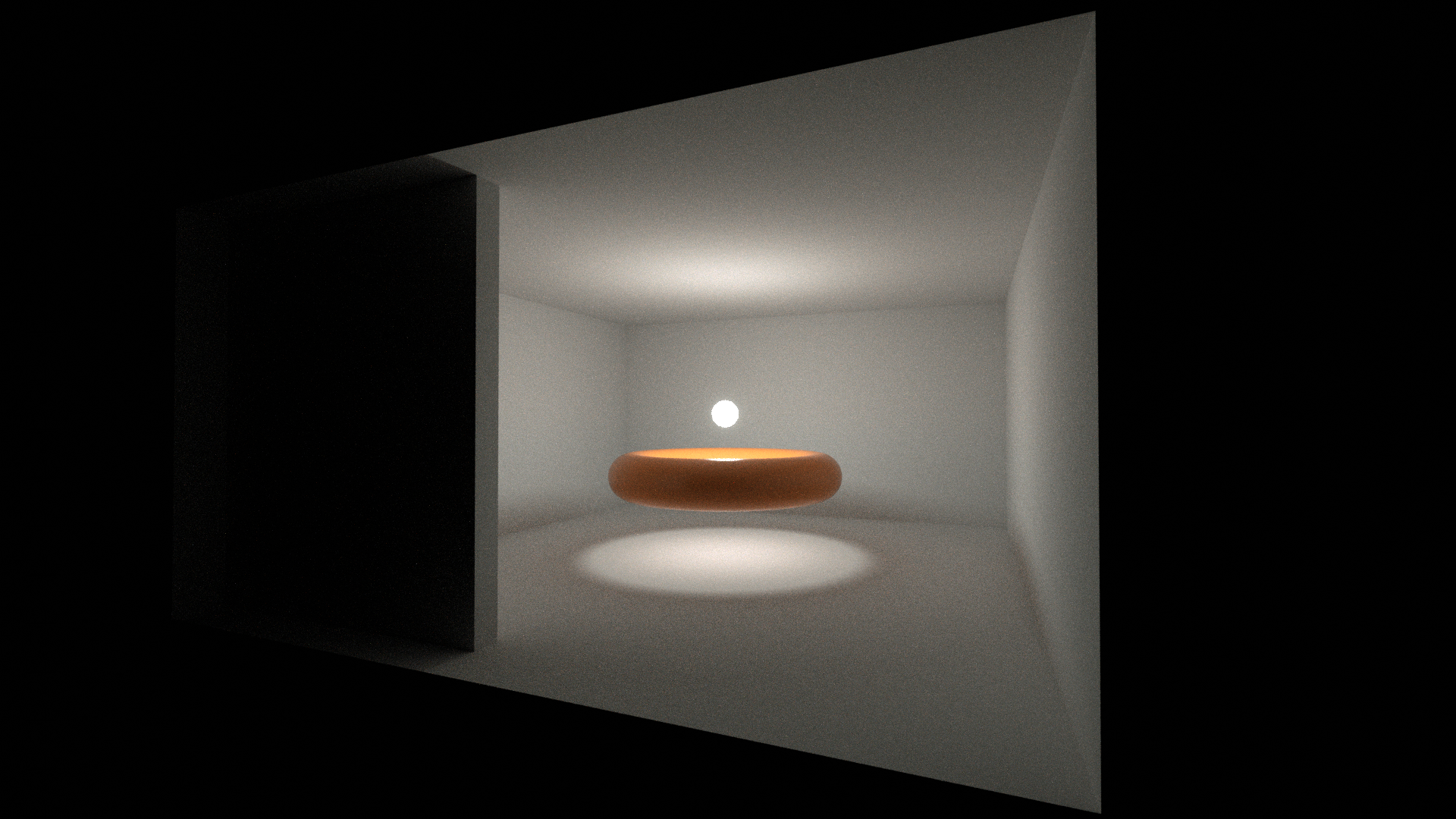

linograndiotoy
Posts: 1509
I've made a simple test in Blender and Spectron Lights are definitely less noisy than Mesh Lights.
100 samples in both cases.
Mesh Light:
Spectron Light:
protovu
Posts: 476
Joined: Thu Sep 11, 2014 7:30 pm
Thank you for posting this.
