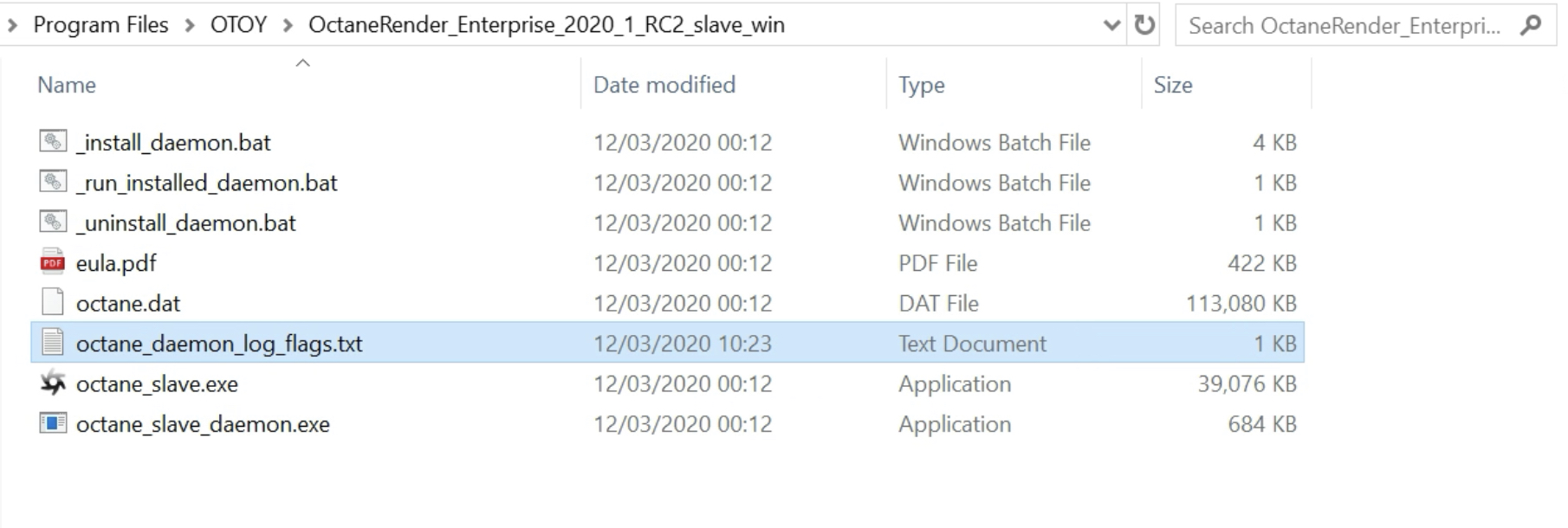

Hi Mike,
do you have RTX GPUs in the Slave machine?
If yes, better to disable the RTX support for now, by adding the following .txt file in the Octane Slave directory: ciao Beppe

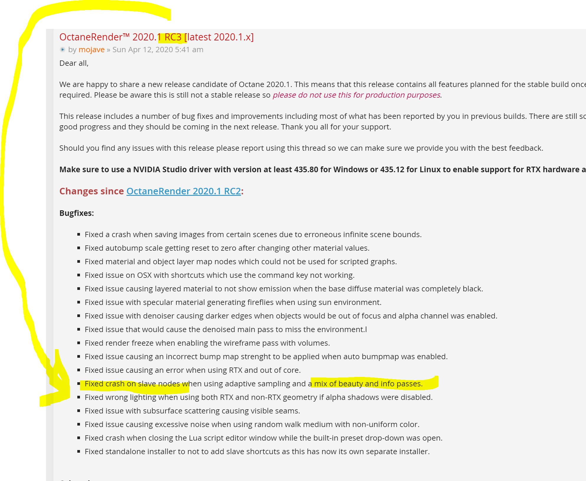

Why i'm angry is, that a few days after my lost post about "2020 Slave crashing"
Mojave releases a R3 Version which "seams" to include a fix for exactely that problem!
But, concerning my problem-post a few days earlier: no reaction, no replay, not even a short "we know that there are some issues - please wait for next release etc..."
Absolutely nothing! - except you of course!
Will follow your advice and mail at otoy-help! Thanks again Beppe!
