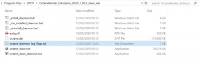

If yes, better to disable the RTX support for now, by adding the following .txt file in the Octane Slave directory:
octane_daemon_log_flags.txt
(124 Bytes) Downloaded 181 times

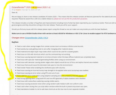

Hi Otoy,
maybe this fixes my problem with crashing Slave?
Will test this as soon as the C4D Version "R3" is out.

Why i'm angry is, that a few days after my lost post about "2020 Slave crashing"
Mojave releases a R3 Version which "seams" to include a fix for exactely that problem!
But, concerning my problem-post a few days earlier: no reaction, no replay, not even a short "we know that there are some issues - please wait for next release etc..."
Absolutely nothing! - except you of course! ;)
