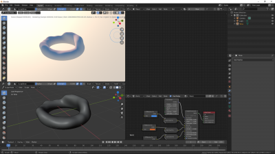

Show Octane Viewport - does it tax the system?
I was using the Octane Server feature in the Blender Plugin to call up the standalone viewport so I could set a render region. That feature works nicely. But I was wondering if it taxes the system and slows things down to render simultaneously to two viewports? Is there a way to turn off the Octane Blender viewport and pipe the real time rendering view just to the stand alone viewport?

What you see in the Blender Viewport is essentially a copy of the Octane Viewport, so performances are perfectly the same when keeping the Octane preview open.

Thanks. Yes I just started using it for various things and really like how it is implemented. Also found it very useful for comparing renders as you can copy paste into photo editor which is a bit more flexible than using Blender's default slot positions.

About sculpting, doing it in the Octane preview directly is not a good idea right now. You can sculpt in an OpenGL view while keeping the the IPR on in another window.
Could you please allow a way to switch the Blender viewport to OpenGL while keeping the Octane Window still running the render?
I personally don't see an advantage in running 2 renders at the same time and in my case it even makes it impossible to work because of the slow
Blender Octane render.

Not sure about what you're asking for. If you mean this, it's possible already:acoval wrote:Could you please allow a way to switch the Blender viewport to OpenGL while keeping the Octane Window still running the render?
I was talking about the separate Octane Window that is not in the Blender Viewport "Show Octane Viewport".
Right now it is connected to the octane blender viewport and if the viewport is switched to OpenGl the Octane Render Window switches off as well.
And since i managed to fix the slowdown in the Blender viewport , I will be using it as well though could you implement a Play and Pause button in the viewport
to start and pause the render?
- linograndiotoy
- Posts: 1464
- Joined: Thu Feb 01, 2018 7:10 pm
The Octane Viewport Window still needs to be integrated properly. It can be useful for debugging but should not be considered a production ready feature right now.acoval wrote:I was talking about the separate Octane Window that is not in the Blender Viewport "Show Octane Viewport".
The idea would be to integrate most of the available functions it offers in the "standard" IPR view in Blender, so there's no need at all to open it.
