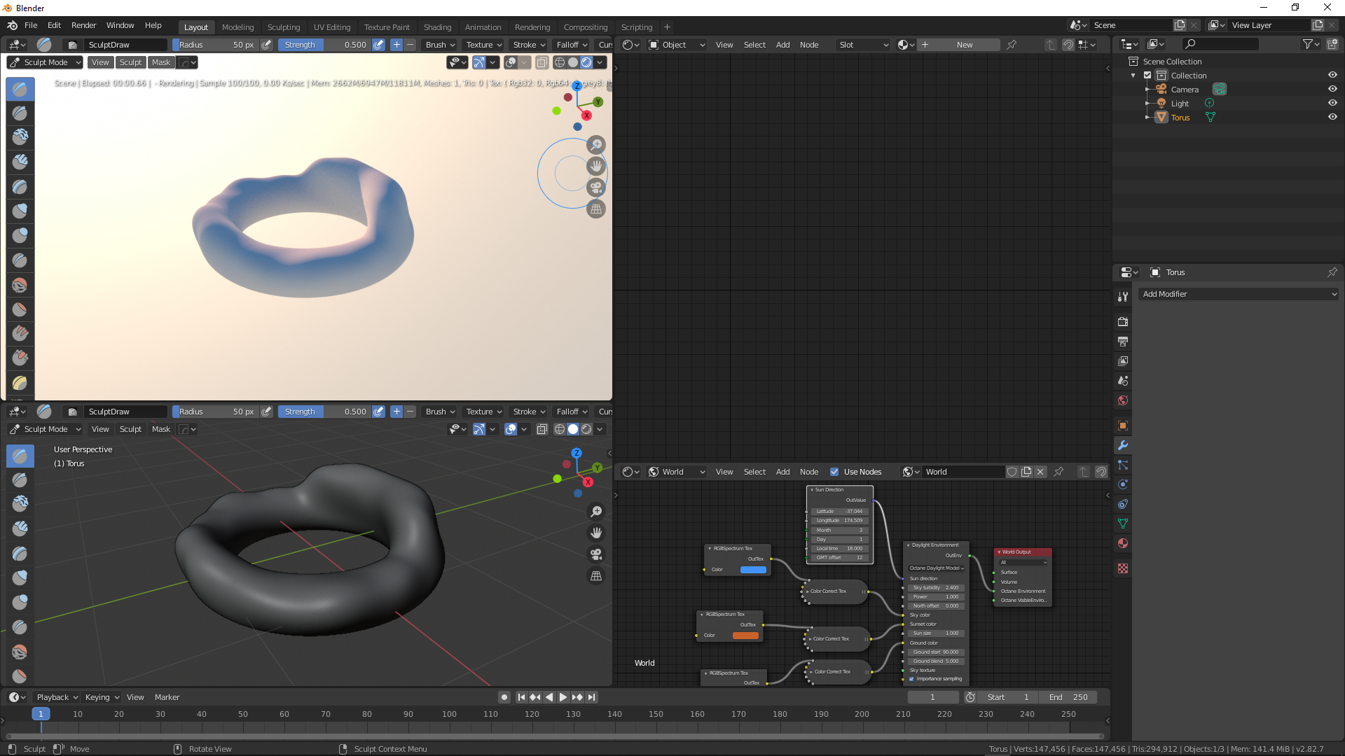

About sculpting, doing it in the Octane preview directly is not a good idea right now. You can sculpt in an OpenGL view while keeping the the IPR on in another window.

linograndiotoy
Posts: 1501
acoval wrote:Could you please allow a way to switch the Blender viewport to OpenGL while keeping the Octane Window still running the render?
I personally don't see an advantage in running 2 renders at the same time and in my case it even makes it impossible to work because of the slow
Blender Octane render.
Not sure about what you're asking for. If you mean this, it's possible already:
