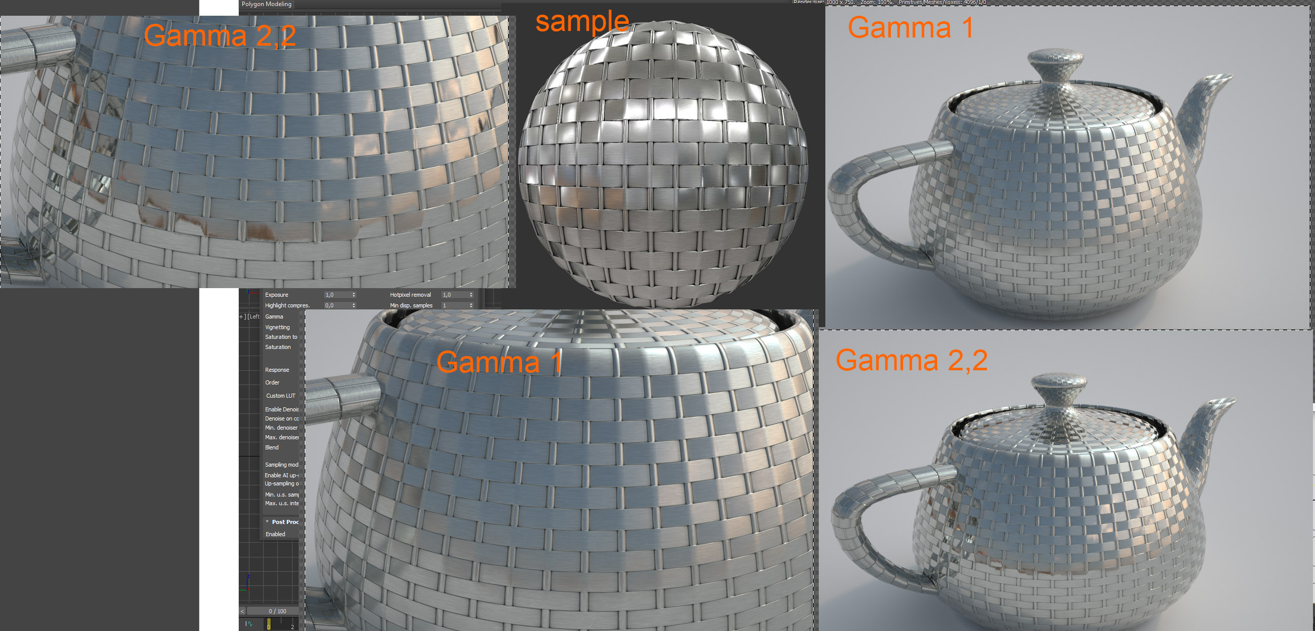

metalness, keep in mind to use grayscale image node setting gamma to 1 (except for albedo).

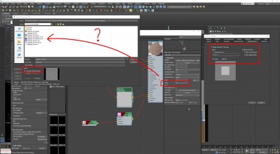

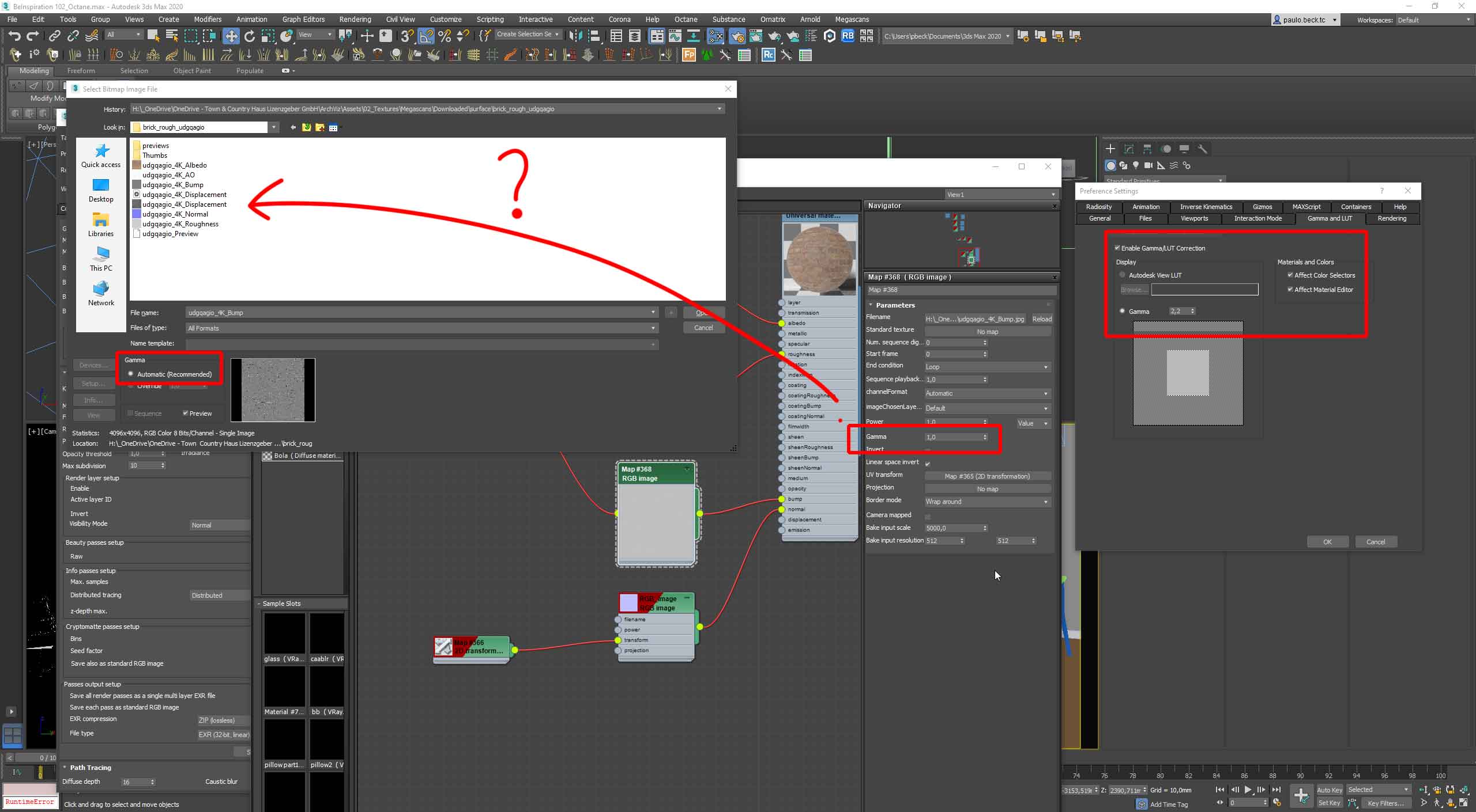

what do you mean all with gamma 1? bump, dispalce, rogh?
Where do you have the documentation on that?

Interesting, Does that mean AmbientOclussion and Normal maps also should be set to Gama 1 or AO should be 2.2 since it's used as multiply on Albeido (no separate AO input in Universal material) ?

paride4331
Posts: 4004
sorry, normal 2,2.

samsue
Posts: 393
Newbie question, but so what.
on RGB Image ->
albedo - 2,2
specular - 1,0
roughness - 1,0
bump - 1,0
normal - 1,0
its right so?

Yes it is right.

paride4331
Posts: 4004
[quote="samsue"]Newbie question, but so what.
RGB IMAGE
albedo - 2,2
normal - 2,2
HDRI 1,0
GRAYSCALE IMAGE
specular - 1,0
roughness - 1,0
bump - 1,0
displacement 1,0
