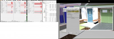

Here's a screengrab of the 2 2080ti's, 1060 and cpu.
max values
2080ti 192w
2080ti 202w
1060 143w
cpu 103w
total 640w
Also, once the 2080's have done the colouring in, they essentially shut down and hand over to the 1060 for denoising so I doubt those max power usage figures all happen together.
Anyway, it seems stable doing it this way so I'm happy. :D

Hi Rik,
these value are not the maximum peak, but when denoise starts, the GPUs gets a maximum peak and your PSU wattage is not enough.
Keep in mind that after a few years the PSU wattage decreases.
Regards
Paride
