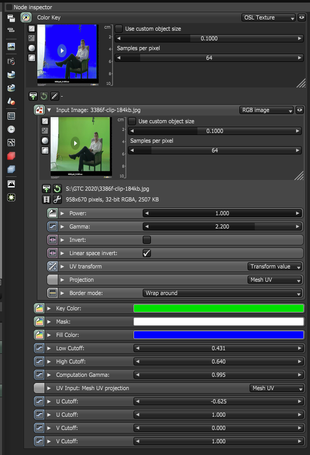

I had a quick look at this. The original script was for 3ds max and has 2 outputs (1 color and the other float)
https://github.com/ADN-DevTech/3dsMax-O ... lorKey.osl
In Octane, we can only have 1 output per OSL node, and it only supports a "color" output.
You would need to use 2 OSL nodes. eg make 2 copies of the script and modify 1 to use the "Col" color output, and the other to use the "Key" float (converted to color).
EDIT: Here is a sample orbx with 2 OSL scripts. I don't know how this is meant to work, but here is a screenshot of 2 planes. You can see through the top one which uses the key as opacity
colorkey_002.orbx
(298.58 KiB) Downloaded 248 times
