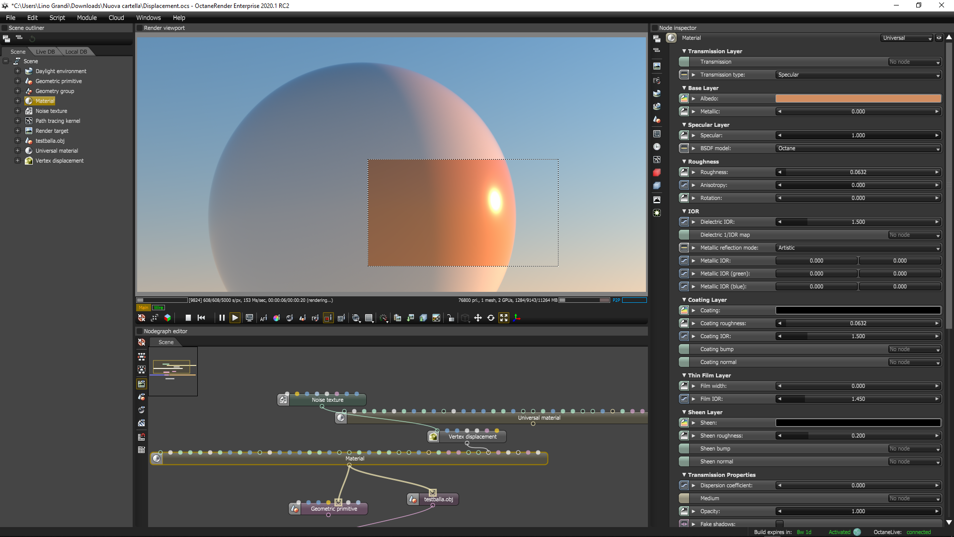

This is something doable in Standalone: In the current internal build of Octane for Blender we've added the possibility to open the Standalone IPR Viewport. It ss only for debugging purpose right now, but the plan is to make all the options you can find in the Standalone Viewport available in Octane for Blender as well.

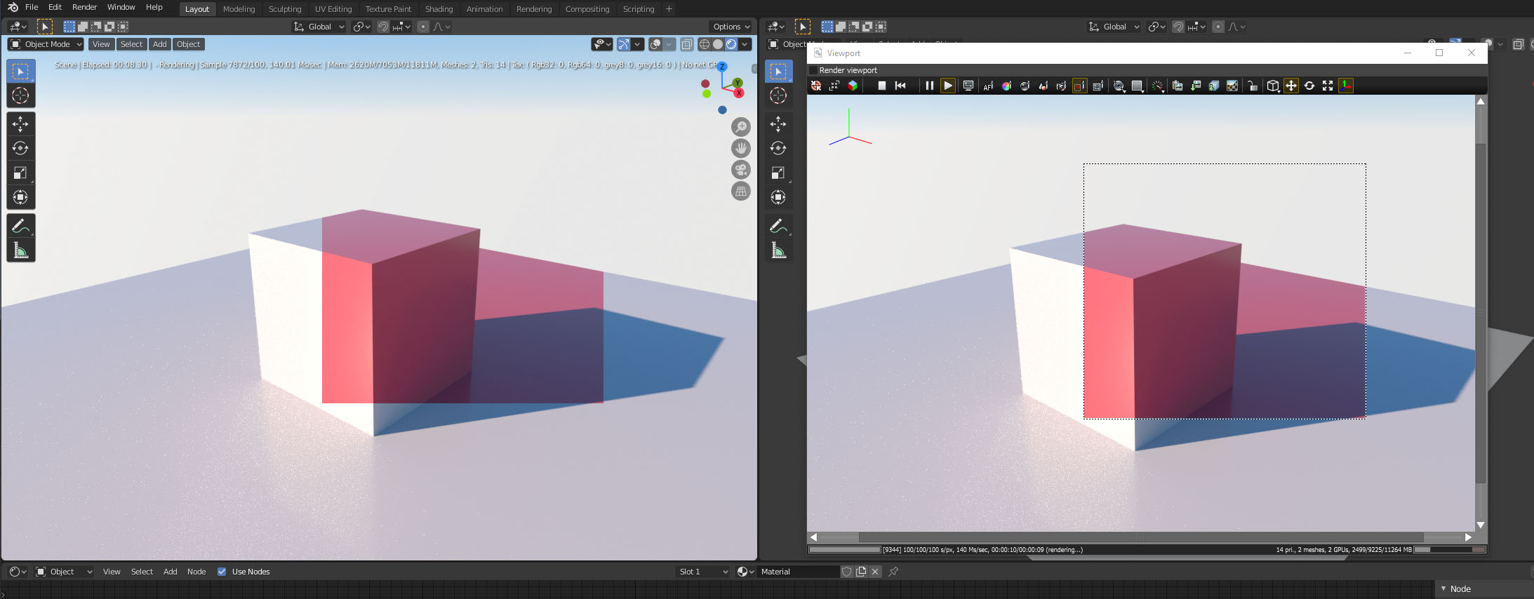

To answer my own question :
I have noticed that if i select a render region in the outside Octane Render Window than it renders the
same selected region in the Blender viewport without hiding the rest of the image. Can be a workaround until you impliment it into the Blender Viewport.
