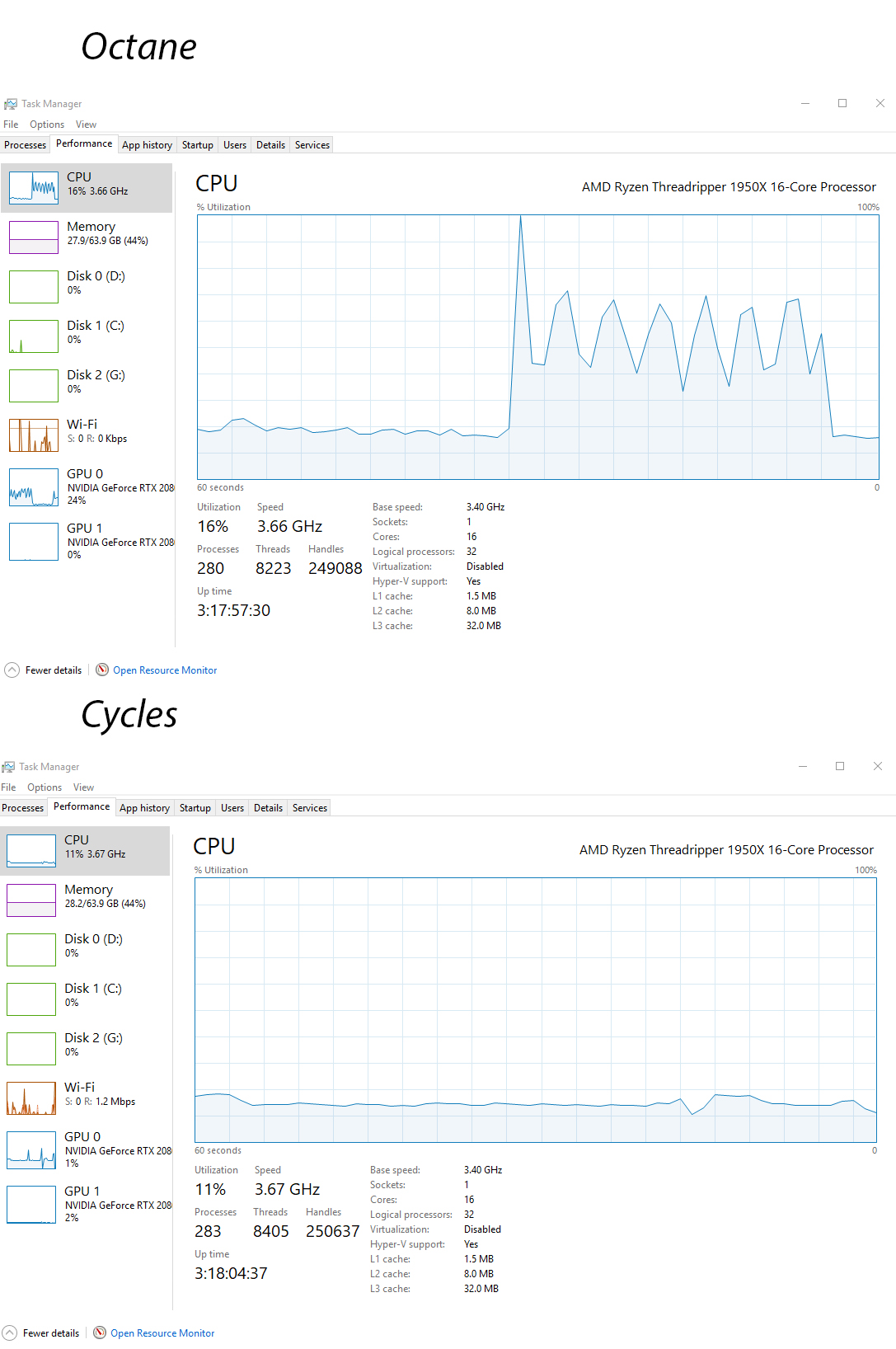

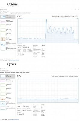

Thank you ... Yes it seems that the problem is with the spike in CPU usage when tumbling.
Here's an example what happens to the processor load when i tumble in Octane vs Cycles.
