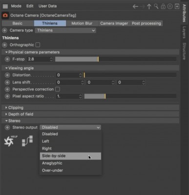

you can do both Side-by-side and Over-under Stereo output with c4doctane Camera tag:

I appreciate the reply, however this is not multiview. A multiview file stores the same scene from multiple different points of view in EXR file channels. A singular file, singular POV image, no side-by-side or over-under. Like switching between an alpha channel and rgb channel, you can toggle between a left and right channel view.
The method you described only allows side-by-side and over-under stereo output in one image channel. I assume Octane doesn't have this capability yet, and I'll have to render left and right separately and join them in Nuke and CaraVR like this.
