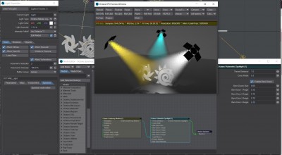

I've updated my Octane builds...been a while....had to wait on some projects to be complete. I'm trying to play with the new Spectron lights and am not finding much luck. Anyone have a sample scene with a simple volumetric light? Documentation link?

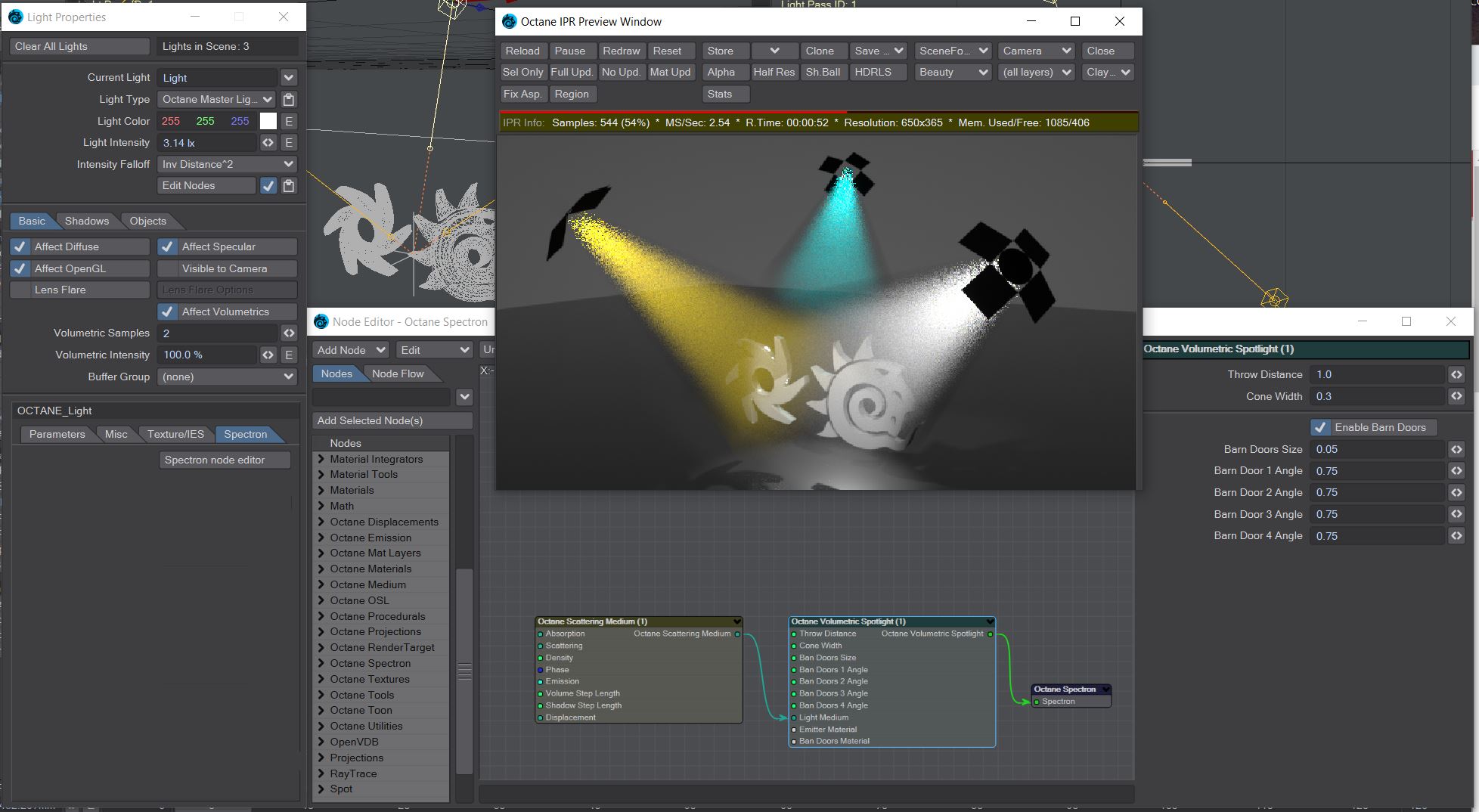

juanjgon
Posts: 8867
Location: Spain
The spectron volumetric spotlights are configured using the new spectron node editor available in the Octane lights. Attached you have an example scene.
Hope it helps,
-Juanjo

juanjgon wrote:Hi,
Hope it helps,
-Juanjo
I feel that's exactly what I had done...but maybe I missed something...possibly in the SCENE or render settings? I'll dig into this scene...thanks!
