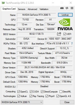

Please, download and run GPU-Z:
https://www.techpowerup.com/gpuz/
And share a screenshot from the Graphics Card tab, for all the available Nvidia GPUs, thanks:

I had the 441.66 Studio driver you recommended in your earlier post.
See attached image for gpu info.
Thanks for the help Beppe!

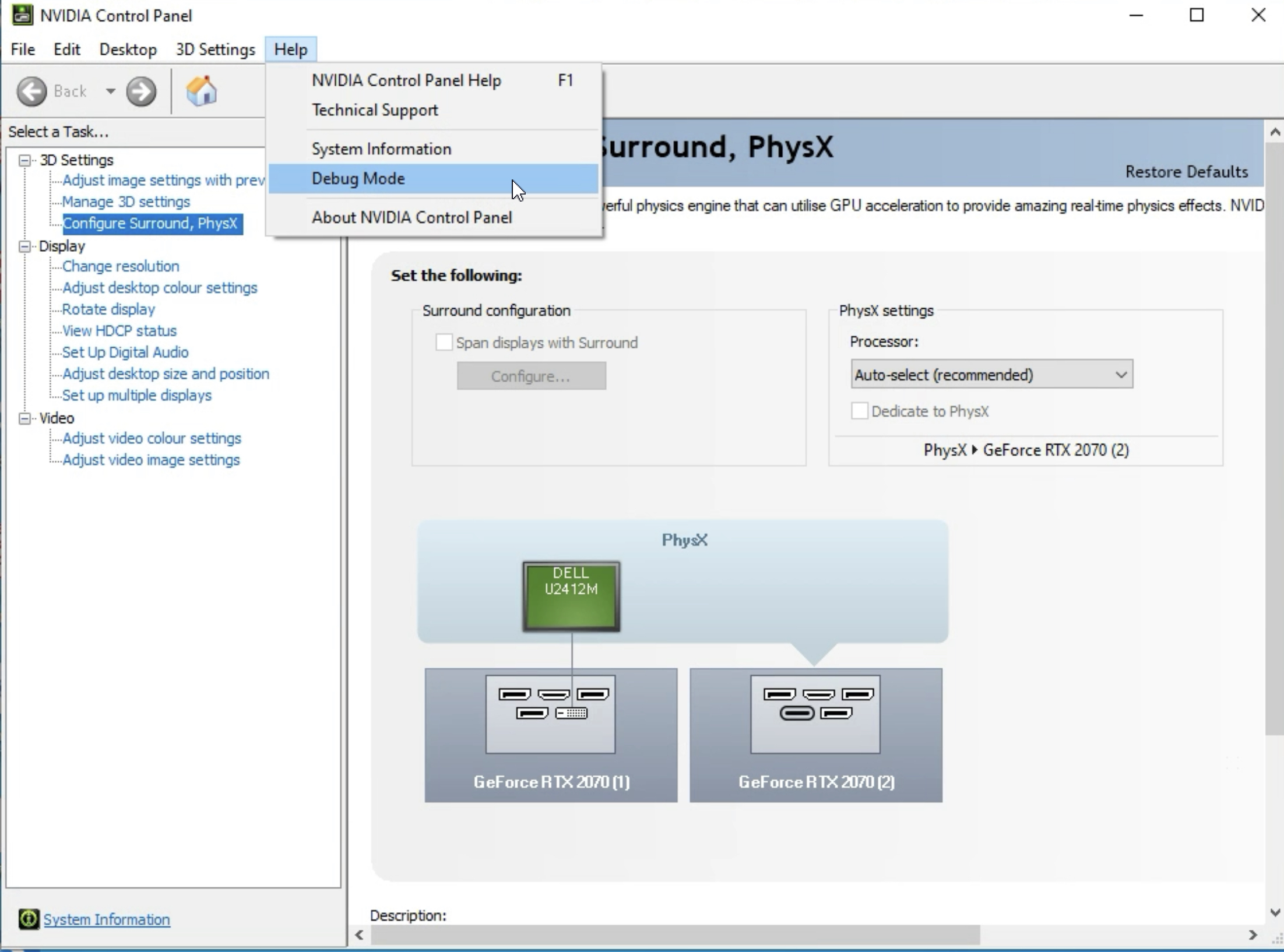

Ok, thanks, please try to go to nvidia control, menu Help, and enable the debug mode, to work with GPUs at default clock:
And please consider that 2020.1 and RTX support are still un beta, so some glitches are expected.
