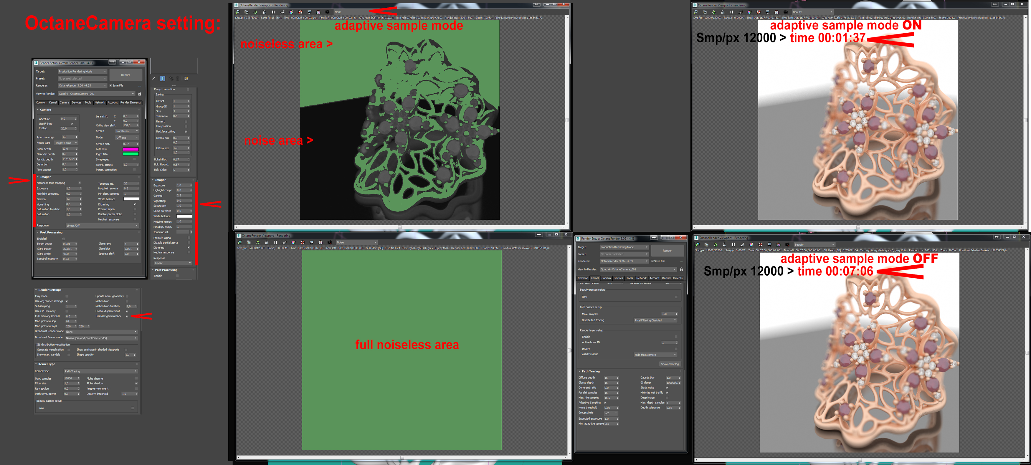

Hi panzer_k,
if you would have really hight quality renders working with caustics and IOR, then PMC kernel is definitely the right choise (PMC_test-file.orbx).
Keep in mind it is slower than Path tracing kernel.
Using Path tracing Kernel (PT_test-file.orbx), you will use powerful tools like Adapting sampling (screenshot 01.jpg) and Ai Denoiser (viewtopic.php?f=27&t=67819&p=339971&hil ... se#p339941) tools.
they will dramatically reduce the rendering time

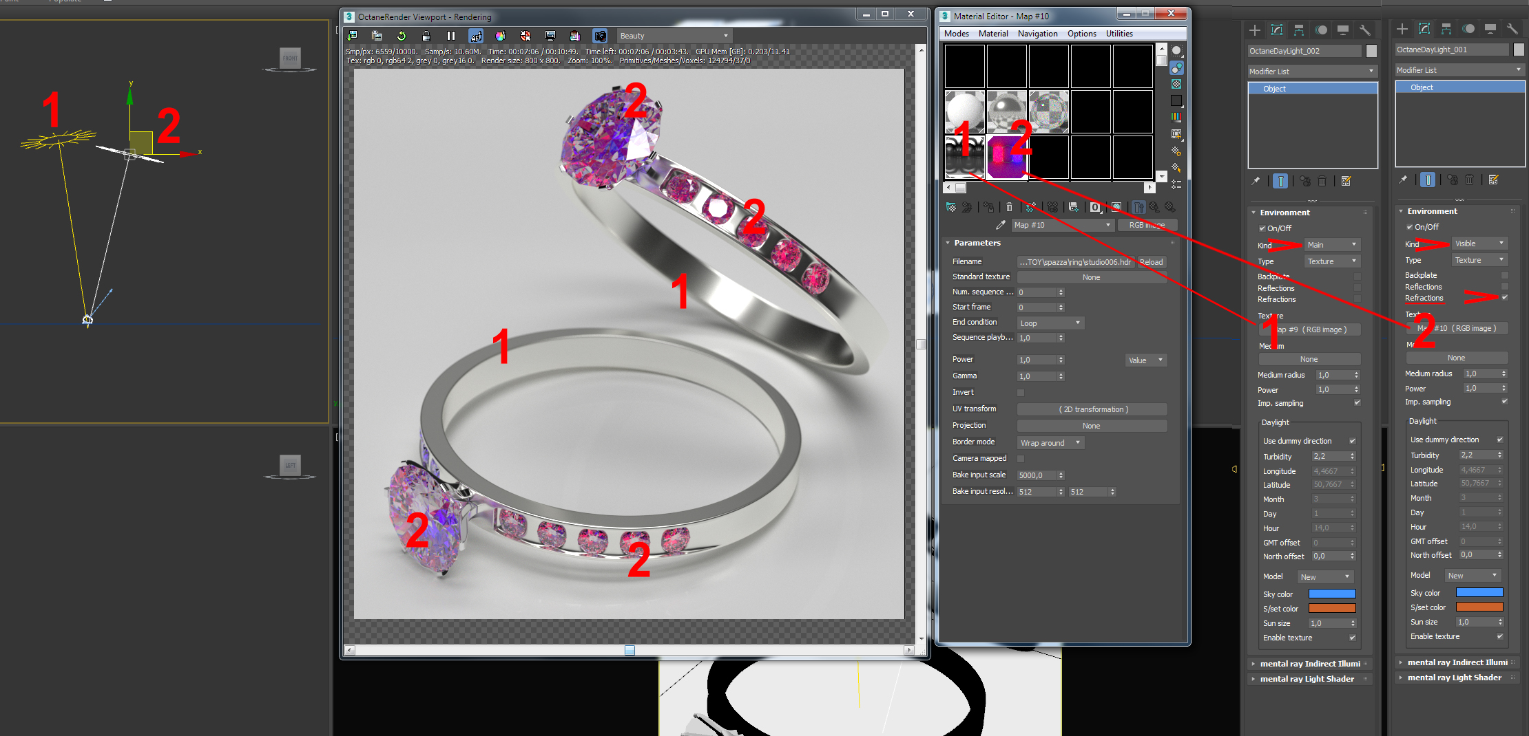

If needed you can use an HDRI texture to light your scene and differents RGB images or HRDIs texture for reflections/refraction (screenshot 02.jpg)
