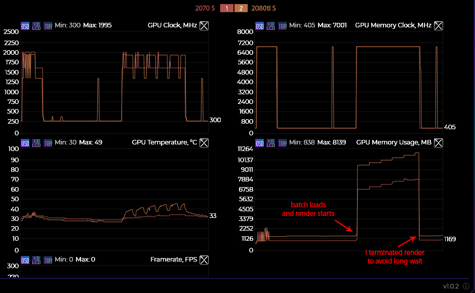

Rendering the side of a mountain. Model is about 700MB 6 x 16K textures on simple Octane Diffuse Material.
All Geometry and Geometry shape nodes have force load disabled. There's only 6 meshes in the scene and one camera, one env map (2K) and one Octane Light.
Notice How my memory mounts over time. I can only reder 6 frames without have to stop the render and restart.
Is this a memory leak?
When I batch render, the memory level drops when I stop the render.
When I Render Sequence the memory level never drops and you have to restart Maya to render more than 6 frames.

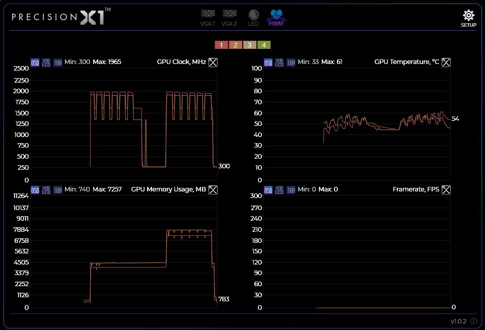

XB3 all fixed. GPU memory usage is now level across render of multiple frames.
The first low readiing is with render sequence. The second higher reading is using batch render.
Thanks for all your attention on this Jim.
