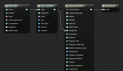

When the Color Correction Node is plugged into the Roughness, the render just constantly restarts 1 sample then again never resolving until you remove the color correction node from only the roughness on a universal material

Like this?
This works for on my end. What other setup do you use?

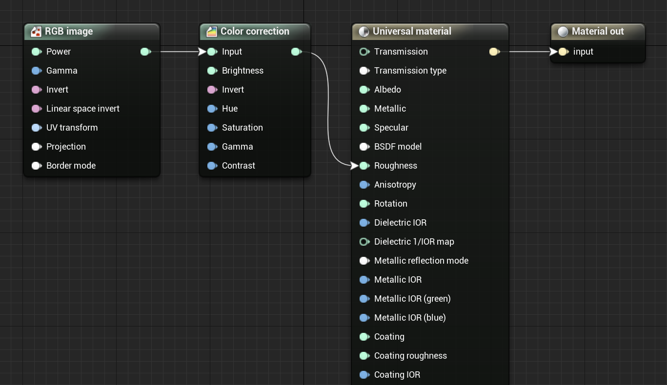

Yes,
I don't have the color correction node in, I am in the middle of a project right now. I think because there was no roughness data to pass on. My fault. The Datasmith actor thing is true, too.
1. Probably because I looked at the parent material and the model was on a SPEC work flow so Roughness wasn't even piped in
2. It was and Datasmith Actor selected and that causes the same thing.
