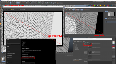

On R21 and 4K monitors (Win & Mac) it's hard to use scale 100%. (Small UI, Small Font)
So I always use a 150% scale. And octane LV is also 150%. It is not real resolution.
At first I thought it was a problem with C4D.
But C4D SDK includes a way to solve this problem.
It's difficult, but hopefully it will improve.

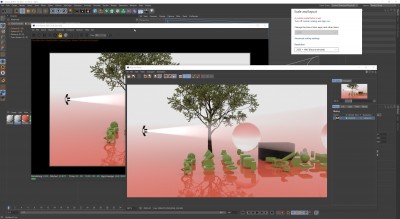

Solution should be using custom font and icon sizes not increasing the Windows scaling. I'm using a custom scaling also see picture

aoktar wrote:Solution should be using custom font and icon sizes not increasing the Windows scaling. I'm using a custom scaling also see picture
Also my computer has several programs. This setting is not useful for each program.
Fonts are still small on 4K monitors. Please test on 4K Monitor.
HiDPI Scaling must be supported, such as Octane for Houdini and Blender.
I hope this feature is added.
