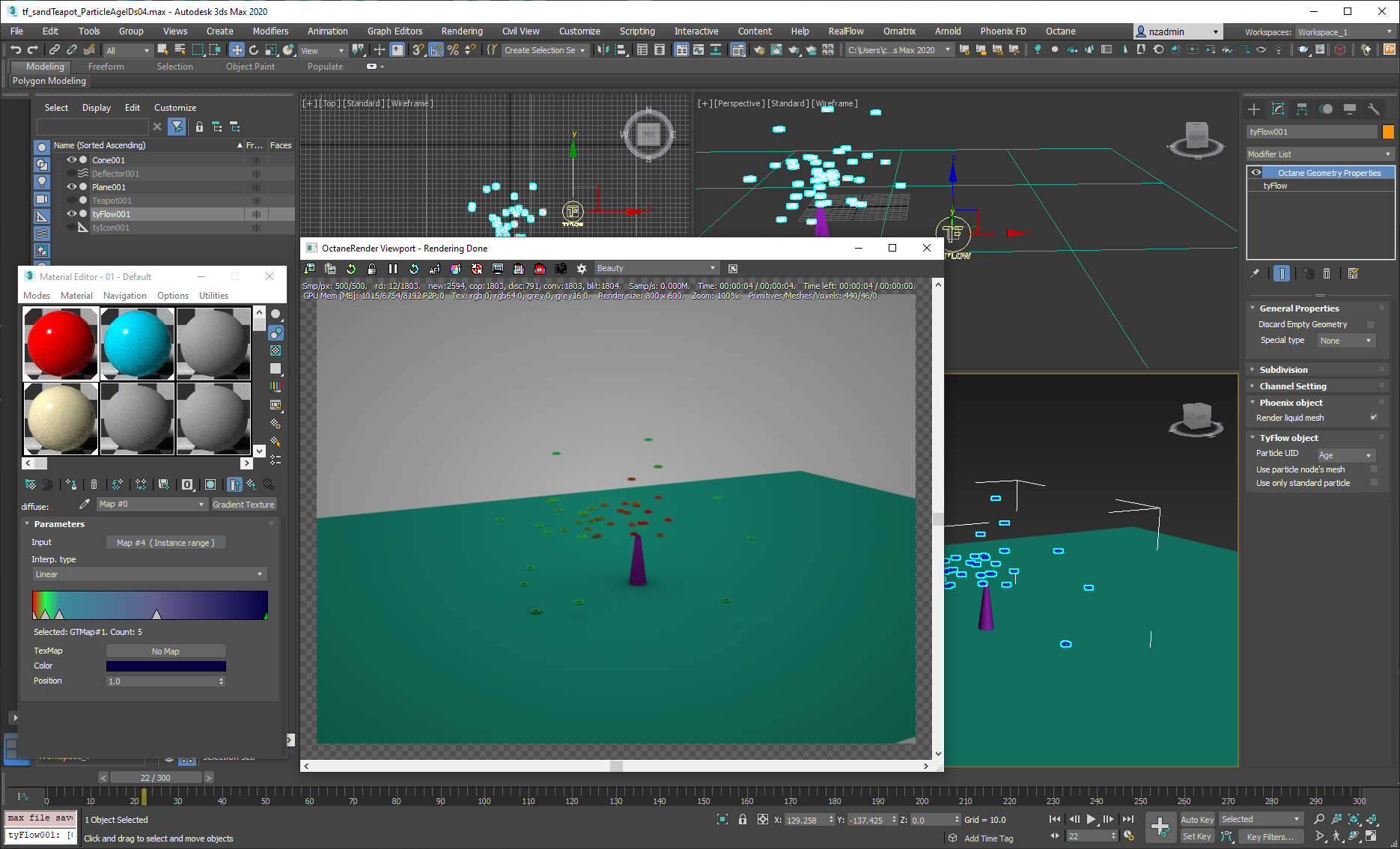

The version 2020.2.1-11.07 now support tyFlow particle age (update for other versions is coming shortly)
Here is a sample and details for the setup:
-Add an Octane Geometry Properties modifier to the tyFlow object (eg tyFlow001)
-In the tyFlow object rollup, set Particle UID mode to 'Age'
This will set the user ID of each particle using their tyflow age (as get from maxscript with [obj].getParticleAge {index} or [obj].getAllParticleAges())
(http://docs.tyflow.com/tyflow_maxscript/)
-This ID can then be used by a texture of the material assigned to the tyFlow object
For this example, an Instance Range texture is used as an input of a gradient texture.
The Maximum ID is set to the length of the animation, in frame count (300)
The new born particles will be red, and as their age increase, they will change to green, up to the dark blue at the end of the gradient.
tf_sandTeapot_ParticleAgeIDs.zip
(51.29 KiB) Downloaded 355 times

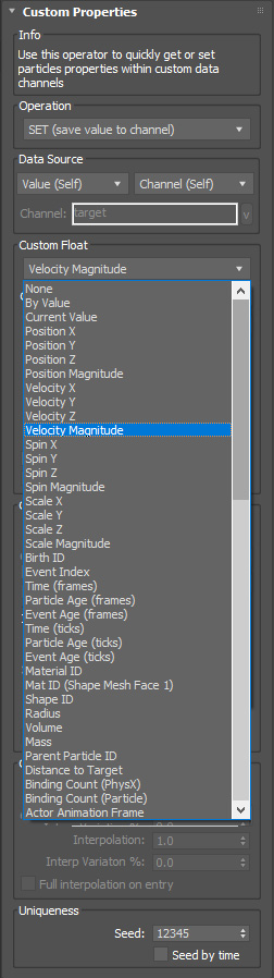

You add particle UID mode "Age". Could it be possible to add Custom properties instead ?
I mean in tyflow we can set custom properties to particles via channel names.
It would be far more powerfull to map particle with its particle data not just age. (see pict)
