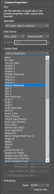

Thank you very much for your file and your explanations.
You add particle UID mode "Age". Could it be possible to add Custom properties instead ?
I mean in tyflow we can set custom properties to particles via channel names.
It would be far more powerfull to map particle with its particle data not just age. (see pict)
