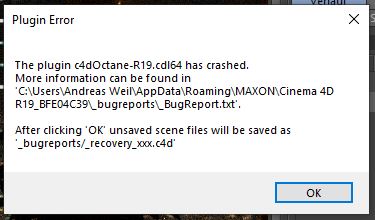

2. Using denoiser function causes Cinema to crash completely after it had rendered first frame succussfully and should start denoising.
Error-message: "The plugin c4dOctane-R19.cdl64 has crashed. More information...."

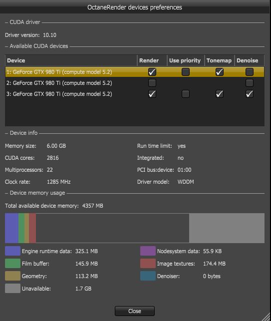

i7 3930 6-Core, 2 x GTX 980Ti
Drivers: tried different from NVidia: 419.67, 431.60 up and newest.

i have the same problem , if i open some files and the scene loads the octane plugin is crashing.
i attached my Bug Report file
_BugReport.txt
(618.49 KiB) Downloaded 235 times
Posts: 16068
Location: Türkiye

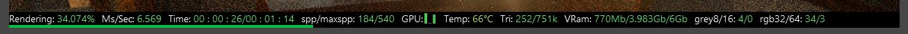

OK bugreport points that's a crash at renderer. Doesn't show what causes. You have to find it. It may be a bug or out of ram or vram. Watch render statistics during render
